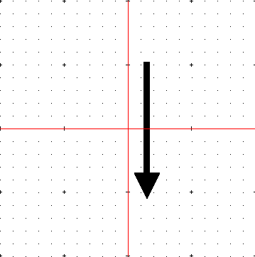

  • I created an arrow as user collection element with a tip using line thickness "thin" (see ElementEditor.png)
  • When placed on a folio in 0.80 the arrow tip is correctly included (see QET080.png)
  • However, if the same file is displayed with 0.90, the tip is drawn with thickness "normal" (see QET090.png)
It seems, that somehow the line thickness of the tip is ignored in 0.90.

Element created on 0.8 AppImage version!
Show on 0.8 AppImage
https://download.qelectrotech.org/qet/forum_img_2/thin_0.8.png
Show on 0.100-dev
https://download.qelectrotech.org/qet/forum_img_2/thin_0.100.png
