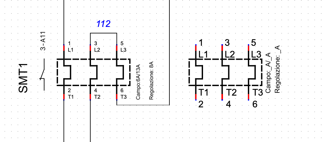

Some colleagues complain that the size of the labels in the symbols (Sans Sherif 7) and/or the contact numbers (Sans Sherif 5) are too small and they struggle to read on A4 paper, and ask me to increase the size of the characters.
Since there are over 20,000 elements in the library (5-600 of the most used obviously...) and modifying them all is quite a problem,  how is it possible to change the font size all at the same time without causing damage?
....and then be able to upgrade the projects already done a year ago...?
I tried to modify them in the elements with a text editor that searches inside each element in the library: ..../QElectro/QE/elements/10_electric/10_allpole/
the type string (sans Sherif,5) and replaces it e.g. with (Arial, 7)
1)es:
Search: Microsoft Sans Serif,9
replace with: Arial,12
2) es..:
searh: Sans Sherif,5
replace with: Arial,7
(See detail below)
It worked and this way it changes them all quickly...
But I'm afraid of doing some damage on other lines...
Is there a way to do this without causing damage?
THEN,
I reloaded both the libraries and the sheets but the characters in the sheets don't change.
The element in the library that I insert as new instead has the characters with the correct modified dimensions.
So how do I update the sheets without having to change the elements one by one?
Can someone help me?
Thank you.

Re: Increase the font size in items and sheets.
Hello Tiz,
change element in collection police size, you need to change for these elements also the UUID/
Put these element in other directory:
see my script bash linux
https://download.qelectrotech.org/qet/s … en_uuid.sh
After you re drad and dropt this element un menu appair chose owervrite all elements placed by the news.
Other workatound it 's to edit XML .qet file.Please backup your projects before try.
