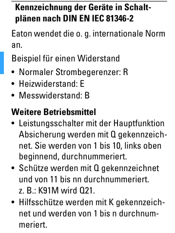

In another context I recommended the "Eaton Schaltungsbuch" formerly known as "Klöckner-Möller-Schaltungsbuch" nomicons/wink
https://qelectrotech.org/forum/viewtopi … 215#p19215
There you find on PDF-page 504 that it should be EN IEC 81346-2 (see attachment)
On page 10-3 there are some examples from that standard.
But I don't know if QET follows this standard 1:1 ...

Danke, EN IEC 81346-2 specifies how the designators are made up by classification. So my "-W"s would actually be "-WGAx" and "-X" would need to be "-XG".
But it does not appear to consider the relations between objects.
61666 and 62491 seem like the right places to look for that.
I might go with "mixed labelling", e.g. "-XG1 / -WGA1 / -XG2" although it would be nice to have mating parts identifyable (to match, but also uniquely). Not sure how to achieve that...?
