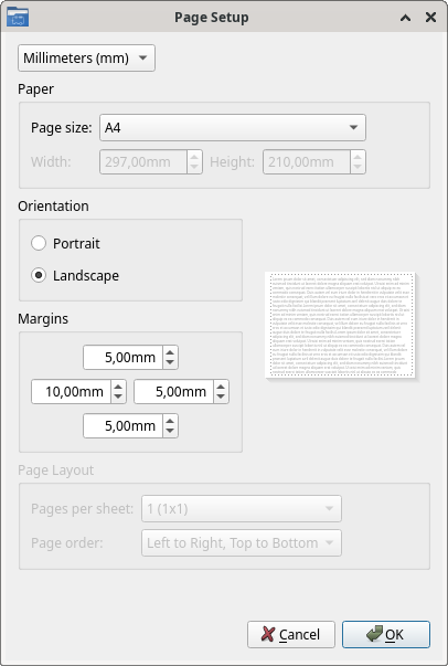

That's a fact: Drawings are not centered on PDF-page.
See also here:
https://qelectrotech.org/forum/viewtopi … 437#p18437
EDIT:

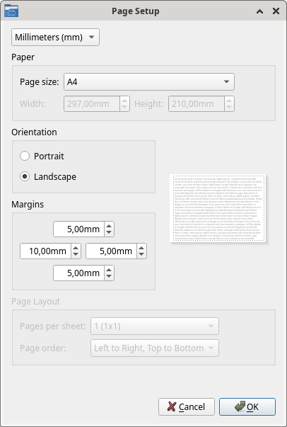

You can "play" with the settings for the rows and cols for your folio(s)
and (at least on Linux-Systems) you can enter margins for PDF-export.
