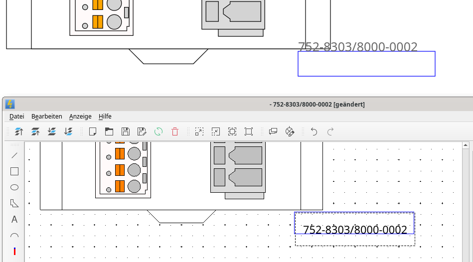

In the moment I think I could make a great step ahead, if I knew how to calculate the bottom-left-corner of the dynamic_text in it's boundingRect.
As you can see in the attached elmt-file I put a dynamic_text at Position x=0, y=5. The boundingRect is positioned exactly there (blue rect). But the text is placed in another position the green rect.
Maybe I find an explanation in QT-documentation from the link how to calculate the "missing values". I have to read.
After that it should be possible to move and rotate the text in SVG to the right position using trigonometry... nomicons/cheerful

I don't know what lib you use to write your converter,
but if you use Qt, you probably can find the bottom left corner by create an instance of QFont and QFontMetric with the specified font read in the xml.
If not (Qt) I think you can easily find lib to achieve this job.
About the rotation of the text in svg, there is the attribute rotate but apply the rotation for each character of the text.
https://developer.mozilla.org/en-US/doc … ement/text
For rotate text in svg you need to use a transformation https://developer.mozilla.org/en-US/doc … /transform
With Qt you can see https://doc.qt.io/qt-6/qtransform.html

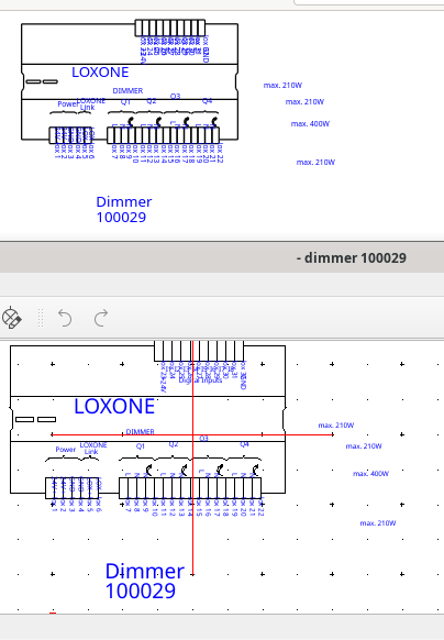

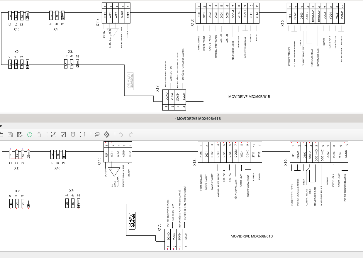

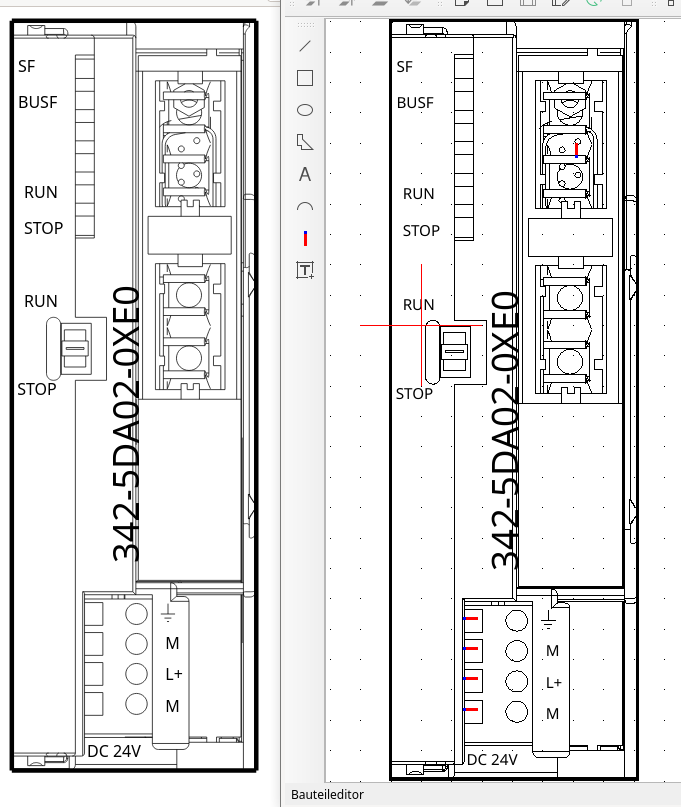

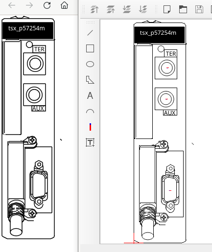

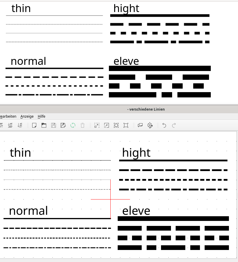

9 (edited by plc-user 2023-11-23 21:42:17)
Re: QET-Element to SVG
Salut Joshua,
I prefer to use plain C++ without special libs that may not be available on other systems, so also here: No QT or so.
It seems that I'm on a good way even with rotated texts!  nomicons/smile
EDIT:
It seems that the standard-value is true for closed in polygons?
Changed that in my code, because the SVGs looked kind of strange and I could not find any ELMT with "closed=true" in Collection!
Attached you find some screenshots to compare SVG.(top or left) and ELMT (right or bottom)
Bildschirmfoto_2023-11-23_20-27-14.png, 60.95 kb, 681 x 807
Bildschirmfoto_2023-11-23_20-30-23.png, 83.18 kb, 1539 x 665
Bildschirmfoto_2023-11-23_20-31-52.png, 30.35 kb, 404 x 582
Bildschirmfoto_2023-11-23_20-33-09.png, 110.95 kb, 1238 x 880
Bildschirmfoto_2023-11-23_20-34-25.png, 36.78 kb, 433 x 515
Hallo plc-user,
Wow that's very good, thank you for the great support.
Best regards

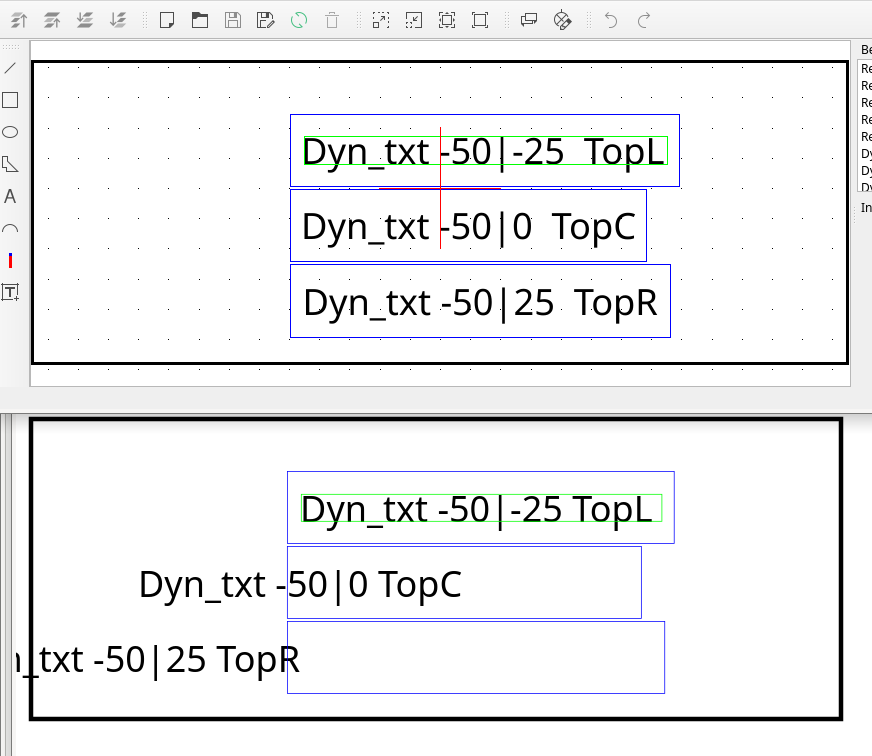

Hello everyone!
For open or closed polygon / polyline I found a solution!
Let's get back to "dynamic_text": Can someone please confirm or explain this:
I have created a test element with three "dynamic_text" and set the horizontal alignment to left, centre or right. I notice that the texts still remain in almost the same X position.
When I apply the attribute left, centre or right to SVG-text, exactly what I expect to happen happens: the reference point of the text is at the specified X position.
That is what I would expect in QET, too...
Hallo plc-user,
ich bin auch schon einige male auf  dieses Verhalten bei dynamischen Text gestoßen.
Ich nehme an Du hast den Text  in den Editor gezogen, beschriftet und dann die Ausrichtung angepasst. Wenn Du den Text in den Editor ziehst (Unterstrich löschen), Textausrichtung anpasst und dann den Text schreibst, dann erhältst du das erwartetete Ergebnis wie auch bei der SVG.
Trotzdem ist Textausrichtung in QET nicht ganz optimal. Hauptgrund ist sicher das QGraphicsTextItem, die Basisklasse für den dynamischen Text, nur die Textausrichtung "oben Links" kennt. Ich denke in QET wird die Textlänge berechnet und damit dann der Einfügepunkt des Textes entsprechend verschoben. Das verschieben des Einfügepunktes kann man auch gut an den x/y Koordinaten nachvollziehen.
Besser wäre sicherlich wenn der Punkt der Ausrichtung auch der Einfügepunkt ist, wie bei anderen CAD-Systemen auch.
Ich hoffe es hilft.
Gruß
Achim
With translator:
Hello plc-user,
I have also encountered this behaviour with dynamic text several times.
I assume you have dragged the text into the editor, labelled it and then adjusted the alignment. If you drag the text into the editor (delete the underline), adjust the text alignment and then write the text, you will get the expected result as with SVG.
Nevertheless, text alignment in QET is not quite optimal. The main reason is certainly that QGraphicsTextItem, the base class for dynamic text, only recognises the text alignment "top left". I think the text length is calculated in QET and the insertion point of the text is then moved accordingly. The shifting of the insertion point can also be easily understood by the x/y coordinates.
It would certainly be better if the point of alignment was also the insertion point, as with other CAD systems.
Greetings
Hello Erik,
Thanks for your hints, but I already use the principle of how it should work with the line ends for the terminals.
If you look at the screenshot, you might realise why I'm still hesitating to implement anything: I want it to look at least similar to QET!
The lines in the image all have the same X values for start and end. The actual lines as you see them have different lengths depending on which line-ending is chosen.
Of course, I could also make the lines in the SVG the same length and place the ends over them. But then you can see the line shining through at ends without filling! In the screenshot you see a yellow rectangle behind the lines.
The complexity doesn't get any less if we think of four possible line widths, for which the "real" line length must then of course be adapted to the line width, the line-endings and the values for length...

23 (edited by plc-user 2023-11-30 19:49:38)
Hello Erik,
Thanks for Testing, Erik!  nomicons/smile
The line you are talking about is a dashed polyline and the "missing" part you mention is just a gap in this line.
If you open the SVG-file with a text-editor and change the stroke-dasharray="10,5" to perhaps "7,3" you'll find other parts of the same polyline "missing".
Maybe we need different dash-to-gap-ratio for different line-widths?  nomicons/ermm
Any suggestions?
I'm sure there's much more fine-tuning to be done...

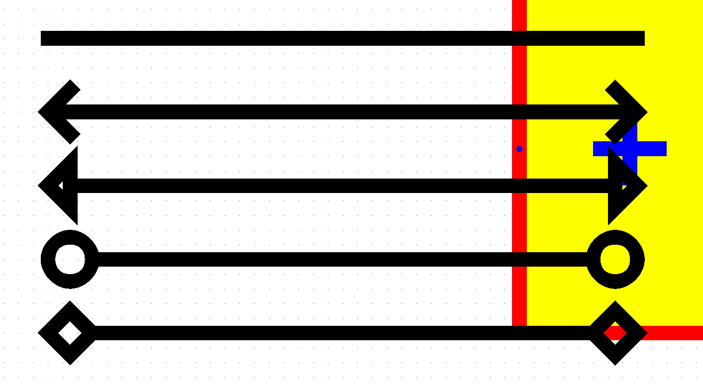

Hello Erik, (and all others!)
on https://github.com/plc-user/QET_ElementScaler you'll find a new version of QET_ElementScaler in which the handling of line-width and line-style for SVG-output is re-worked.
Here you see an example in the picture (top: SVG, bottom: Element-Editor) and in Element- and SVG-file.
Additionally your example with the re-worked styles is also attached.
I guess I found a quite usable solution...
Please test the new version with your "favorite" elements!
Thanks in advance!
Best regards
  plc-user
