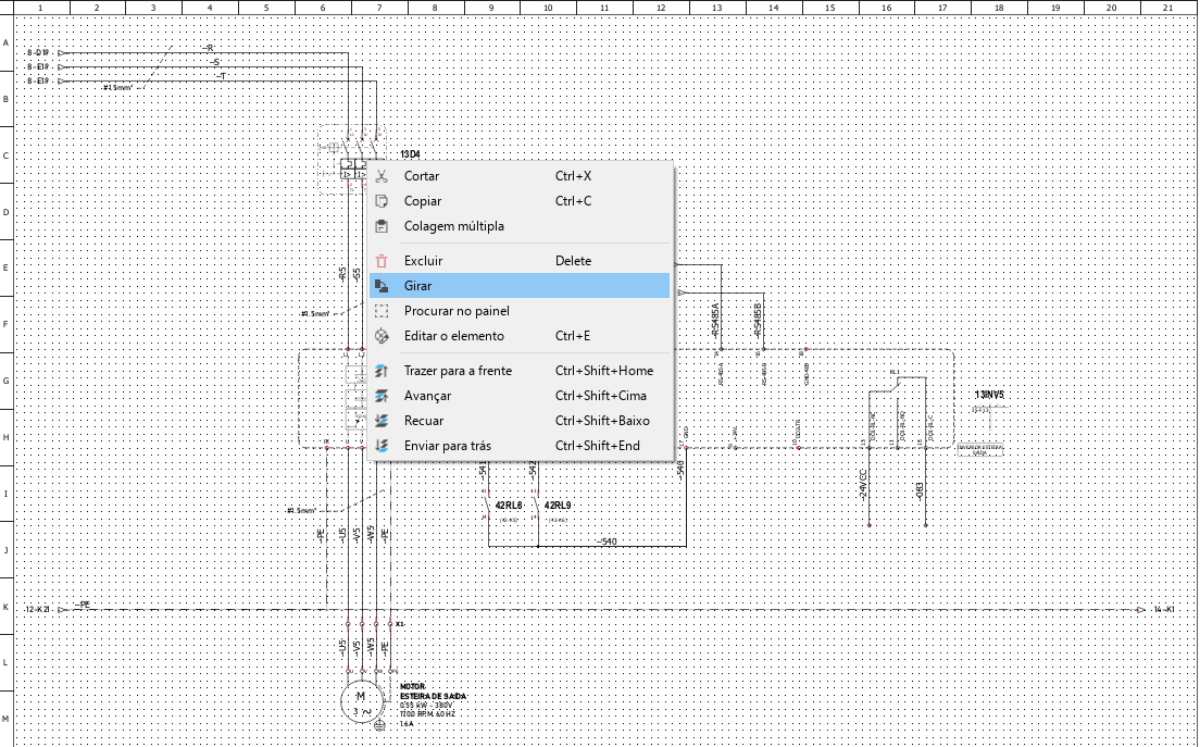

Hello
I use Windows 10 Home, version and QElectroTech-0.100.0_x86_64-win64+git7868-1.
And I can't find that option.
follow photo to evaluate.
grateful.

but it doesn't work, you can even see that the option to use the keyboard space key as a shortcut for the function is not available in the pop-up.

Maybe is possible this a very very old symbol with tag "orientation="dnnn""
Rotation option was removed since..
-> https://qelectrotech.org/wiki_new/doc/x … _l_element
Element orientation
It is then necessary to define which are the possible orientations of the element. The orientation of the element is used when laying conductors but also to prevent the user from turning an element in a direction that would not make sense. The orientation attribute is defined by a sequence of 4 characters, each character defining the behavior for an orientation.
1st character : North
2nd character : East
3rd character : South
4th character : West
Each character can have the following value:
d for “default”: indicates that, by default, the element is considered to be oriented in this direction. It is absolutely necessary to indicate a default orientation.
y for “yes”: the user can orient the element in this direction.
n for “no”: the user cannot orient the element in this direction.
Example: orientation=“ydny” means that the element is drawn facing south and can be rotated north and west but not east.
