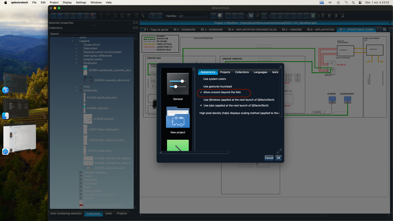

I don't know, but you could try this?
"Allow unzoom beyond the folio"
BTW, have you tried lastest macOS  arm64 packages, I don't know if is work on your Ventura, or maybe your mini is a Intel chip?
I guess I have a different kind of meaning about that function, but its not what I request.

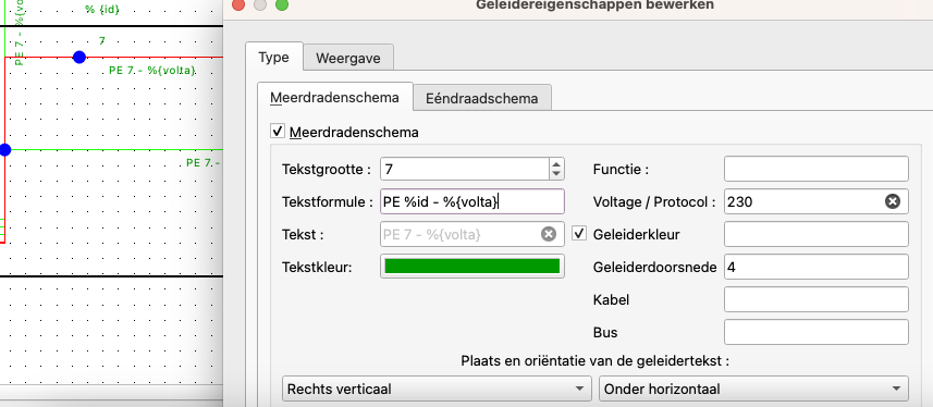

How does the formula in a text field work? If I use the sample volta - "1754" it doesn't work. I see at other place they use the {} and at other places they don't or it doesn't work with the {}. Is that a Mac thing?

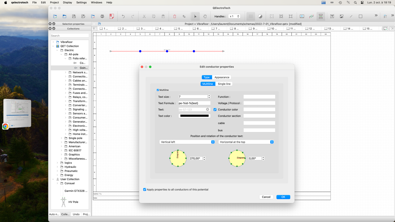

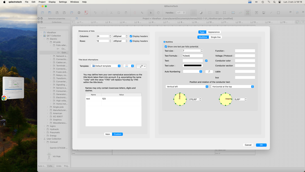

One you need to add this variable on your titleblock like me or add these in so in project settings or in only a folio..
test -> 123
For example: conductor formula is: pe-%id-%{test}

Workaround: If your conductor formula didn't work, try save and re open, that strange but it 's working..
So I recommend to use braces: "%{}" for your formulas..

I have the same things on Debian, if I use a titleblock variable used by cartridge also and if I use conductor formula PE-%id-%{volta} the formula didn't work, so I double click on conductor and replace {} by () and it matchs at moment also then you re open it didn't work .
but if variable isn't a tiitleblock use {} for your conductor formula..
I don't know what as changed, maybe Qt 5 version Qt 5.15.10....?, or lastest merge...?
So I also have the same problems on my Debian Oho... So I recommend to use {} for your formula..
Edit: isn't a Qt framework problem, just tried with latest AppImage I have builded and I saw the same problem, formula didn't work, ok after saving project closed and re open project..
