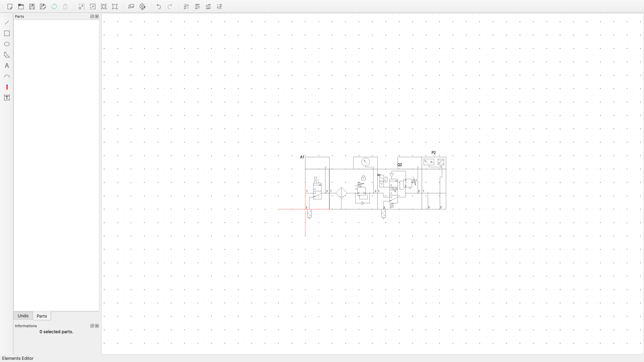

Little test on M2 MAC.
Capture d’écran 2023-11-05 à 09.09.21 - Grande.png, 90.18 kb, 1280 x 720

I open your DXF with QCad, ctrl +A for select all parts, in Block menu I Click on explode and after I save file, now your DXF work whit QET dxf2elmt pulgin.
https://download.qelectrotech.org/qet/forum_img_2/dxf_illustrator.png
See https://github.com/antonioaja/dxf2elmt/issues/2
