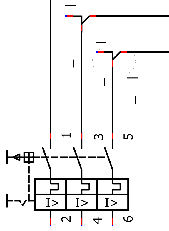

I need some other elements, so I thought I should draw. I wanted to match an existing element's contacts, so I copied from one to a new element page. When I wired them up in a circuit, I couldn't get straight wires from one contact to another, there is always a step in it.
Any ideas ?

element terminals must be aligned with the element editor grid with a step of 10px.

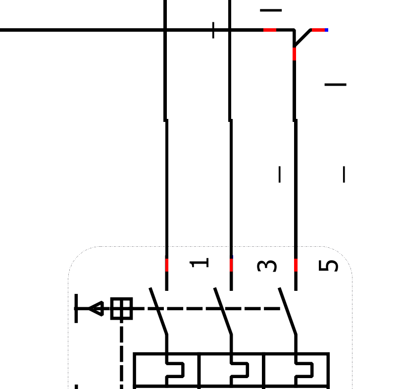

Fixed, I edited second circuit breaker and moved all parts a little, re drag and drop, save and reopen project, voila.
