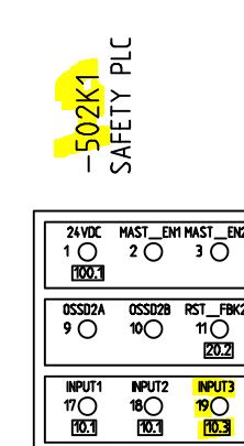

I'm struggling with the cross references of elements. I have a "paper wirings" with something I would like to implement on Qelectrotech ( by the way I'm using v 0.100.0-dev)
I have a safety relay named 502K1  at the page 502, column 1, with inputs outputs and bla bla ..., let's focus on input 3 ( picture input3.jpg), as you can see there the input 3 , #19 , has a reference to 10.3, which is the reference of the paired element
At page 10.3 I have a "box" who has the reference to the input of the safety relay (box.jpg) there you can see the reference to input #19, named input 3 page 502.1 and element 502K1

Re: Struggling with cross references on elements
Hello again
I made a master <> coil because otherwise appears the  NO/NC cross and a correspondent slave
I can write on the master the necessary data :"19", "INPUT3", label "K02K1" and therefore the position which I can modify its position and appearence at the element configuration
But I still miss how to point the slave from the mater (10.3) at the example because the only way I've seen is declare the amaster as a coil and therefore pops up the NO/NC cross pfffft
Any idea?
Regards
Use it like report link.
