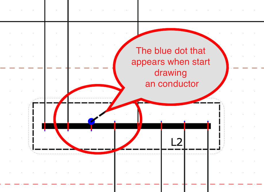

Request - Is it possible to change the icon to a cross when after dragging ( drawing ) a conductor to another terminal ( blue dot ) then I can see the blue dot better. When the blue dot is pointing upward ( vertically ) the cursor covers often the dot ( zooming in is sometimes difficult to see the start and end point of a terminal at the same moment. I hope you understands what I ment. Or maybe the dots and the snap should be wider/bigger.

Not the handles of an selected element or conductor; but the small dots mostly blue but some times red.
Screenshot 2023-03-27 at 12.19.11.png, 155.84 kb, 918 x 670

Re: Bug or... Some inconsistency

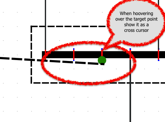

And then a crossed cursor/pointer to see the dot better.
Specially when zoomed out, the dot is not very visible.
At least on the mac it is hidden behind the mouse pointer.
HTH to get the idea
Screenshot 2023-03-27 at 12.22.22.png, 66.35 kb, 530 x 392

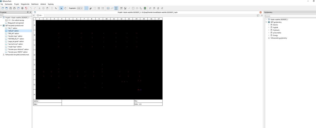

When i reopen a saved job i just get a black screen.
What could it be?

What your OS and QET version?
Sometimes it's a GPU driver's problem...

OS Windows 10 Pro, QET 5.15.9
In the meantime I realized the problem. The document size was too small and when I turn on the display grid buttons, it gives a homogenous dark background because the grid lines are so dense.
