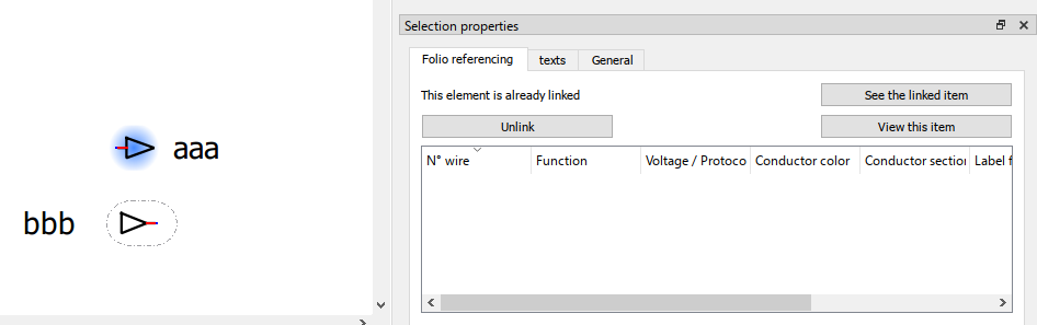

I have setup a crosslink but i had to set the display text to user defined and input my own, not as easy as just double clicking and putting in the part name like with resistors.
The link itself shows up blue but i dont see the link name (bbb/aaa) in the list. And clicking, shift/alt/ctrl clicking, double clicking does not jump the the other link either.

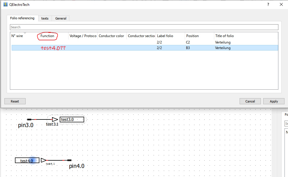

i have figured it out now, but i thought the links would still be clickable after an export to pdf? do i have a setting wrong?
i read in the patch notes (2016?) something about it being possible now.
also can you give the references custom names that show up in the reference linking panel?
Just name your conductors and you see it in report link dialog.
You can also filter and search by conductor name, etc.
