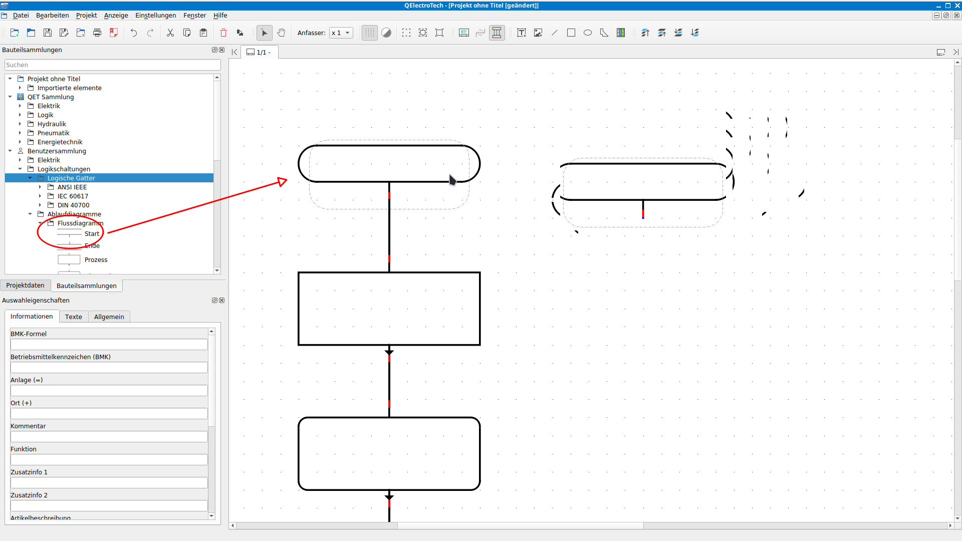

A problem that already occurred when editing the pneumatic symbols is still there.
If the element is in the form of a horizontal tank, it will already be displayed incorrectly
in the preview and also in the plan page. With the pneumatic symbols I have to solve the
fact that I inserted a component from an old library. I was not allowed to change the
component, otherwise the error occurred again.
Maybe you could take a look, but there's no rush.
Attachment icon Bildschirmfoto_2023-01-20_17-13-38.png 122.93 kb, 51 downloads since 2023-01-21

This element are a wrong hostspot, just open in editor and save again.

Re: Problem with displaying elements
You are perfectly right, Laurent!
Corrected the files from packed file with QET_ElementScaler and added here as *.tar.gz

The definition-line of your Start-Element has these values:
hotspot_y="14" height="40" width="90" hotspot_x="45"
and shows the graphical errors.
The corrected version of the file from QET_ElementScaler has these values:
hotspot_y="15" height="40" width="110" hotspot_x="55"
and shows perfect graphics.
When I re-open the corrected file in Element-Editor and save it again, the false values are written to file again.
It seems that the calculation of hotspots and size of the element is broken in Element-Editor at the moment...

Hotspot miscalculated the rounding of the arc, a workaroud is to add 2 invisible little line on the two arc center...for the moment.
