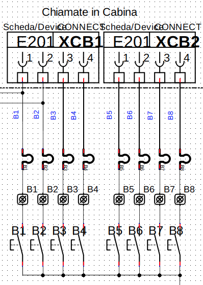

To avoid problems, I installed Kubuntu VM on Parallels MacOS.
The character set is different and creates graphical problems in the drawing and in the element library.
How can I globally replace fonts with similar sized ones on already completed projects?
Editing every single line of text or element in every single sheet is impossible!
Text original MS sans sherif 9 or 7. I can't find them for linux..
Replacing it with one of similar size in "configuration", how can you do a "live refresh" on the project sheets?
If that's not possible, is there a way to change the library and then "live update" the schema with the new library?
Thanks.

Re: Fonts problem with migration from MacOS to VM Kubuntu Linux
Hello Lorenzo,
I had already done what was specified in point 1.
I had installed several fonts but the sans serifs were still larger in size, I also adopted the Microsoft fonts with windows and I can't find them in linux...
I managed to correct the schema using Kate and replacing Sans... and MS with compatible Noto or Arial. Arial which is also standard for everyone.
But I still have to edit all the elements part!
I managed to change the "specifiche.elmt" and *.qet schema but I don't know how to set the Arial standard and size to "elements".
Do I have to edit EVERY *.elmt file?
there are many!
Isn't there another system?
Hello Laurent
Thank you.
I had already downloaded several very compatible fonts in size but the problem is declaring it in the various files.
I solved on the schema with the "replace" command in Kate.
Example: "sans serif,10" change string to "Arial,9" , "all", done.
But the problem remains in the elements, I should do it for everyone and there are many!
It's not like you can make me a script that looks for the string in every file in the diresctory e.g. <114_connections>... replacing type "Microsoft Sans Serif, 12" in "Arial, 9 " or other character and replace it automatically in all files present in that directory ??
Bye thank you
