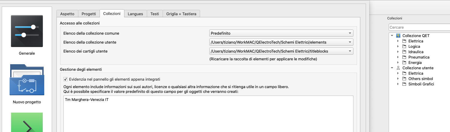

hi,
I made an identical copy of the QE library in my user folder then defined it in setup and it loads it. I modified some symbols to adapt them to my needs and integrate them with other symbols created with the editor...
Attachment icon Schermata 2022-12-20 alle 16.18.44.png 117.72 kb, 71 downloads since 2022-12-20
