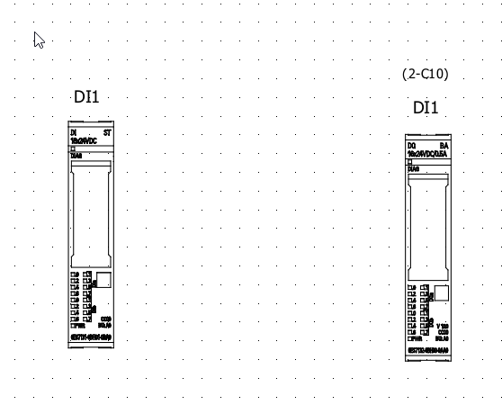

Hello. In picture module on left is Custom master - Coil type. On right module is Slave, switch state: Other type. I'm happy with Slave having reference to master and Master having no switches references. But is there any way how to make reference to Slave in Master element, when Slave is not a switch like on picture? I mean directly in element, not using refmaster.emt and refslave.emt in folio.

Maybe see this https://qelectrotech.org/forum/viewtopi … 64&p=2
https://download.qelectrotech.org/qet/forum_img_2/other_option_improve55.png
Hmm, like other we can add more others options in future like: link to thumbnails slave,
https://qelectrotech.org/forum/viewtopi … 159#p16159
I/O input slave, I/O output slave, etc is a simply slave linked to master but with new pictures symbol for these new slave options Xrefs.
3 (edited by Helios21cz 2022-09-19 08:57:28)
Re: Custom master reference to slave.
That is a solution, unfortunately even with help of google translator I don't have slightest idea how to achieve it.

5 (edited by Re-searcher 2022-09-21 09:26:25)
@ Helios21CZ
My native language is Dutch.
The Right module on your picture is an output module.
It must be DO1 and not DI1
Re-searcher wrote:
@ Helios21CZ
