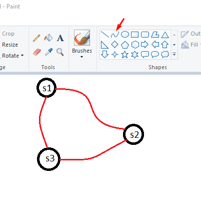

One thing I'm missing is a bazier curve connector or line to be used ie. state diagram drawings (abstraction above SFC/Grafcet) or as a notification textbox arrow.

Bezier curve or only curve line. This is usually seen eg. UML-diagrams etc. for general purpose programming languages. I don't exactly know how it would fit to QEDs other linetypes or fileformat etc.
Here is example from Paint
https://qelectrotech.org/forum/misc.php … =4909t2127
