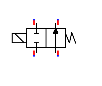

There is exactly one problem with the symbols falling apart in QelectroTech. The terminals have moved.
They are fine when opened in the editor.
But not just the ones I created, but the built-in elements as well.
The text sizes have changed, moved out of position.
Also in the previously saved project.
Restarting the computer did not help.
A lot of my work has been damaged this way.
What can I do? What can cause this?

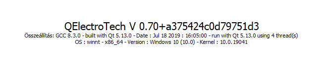

Re: elements connectors slip apart
I you see my PDF your project run well on 0.9-dev but also on 0.8 version.
I understand well you have this problem only one Win 10 machine? and this project run well on another Win10 machine, yes?
14 (edited by mezga 2021-03-30 16:08:16)
Exactly.
In the another machine QE version.
