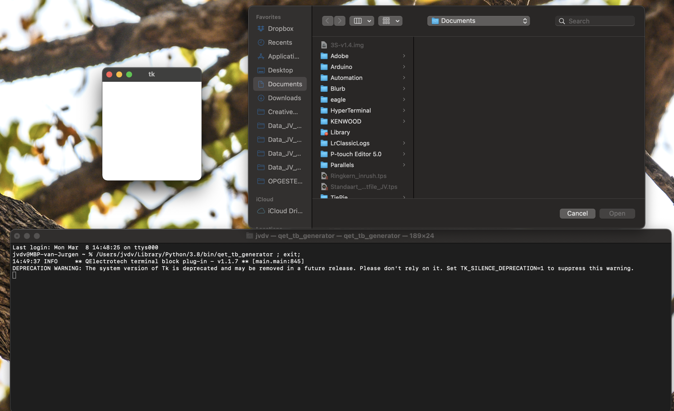

Re: QET V0.8 - TB Generator V1.1.7 - MAC OS 11.2.2 - Python 3.8
When I do that i get 3 screens to open.
Please find attached the printscreen.
Schermafbeelding 2021-03-08 om 14.50.10_resize.png, 636.52 kb, 1358 x 829
OK, plugin run, but QET search plugin in this path
#elif  defined(Q_OS_MAC)
    if (openedProjects().count()){
        success = process->startDetached("/Library/Frameworks/Python.framework/Versions/3.8/bin/qet_tb_generator", {(QETDiagramEditor::currentProjectView()->project()->filePath())});
    else  {
        success = process->startDetached("/Library/Frameworks/Python.framework/Versions/3.8/bin/qet_tb_generator", {("")});
https://git.tuxfamily.org/qet/qet.git/t … .cpp#n2344
/Applications/Python\ 3.8/Update\ Shell\ Profile.command ; exit;
Qet_tb_generator path need to be in this path for is open with QET
not in Users/jvdv/Library/Pyhon/3.8 ....

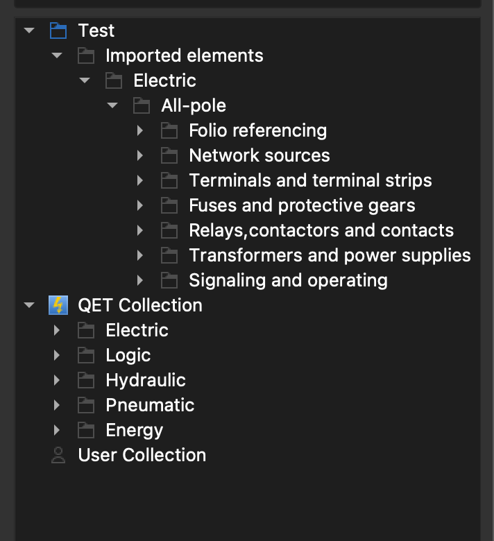

I had a look at some youtube tutorials (posted 4 years ago) but they reload collections
Which I tried, but nothing showed up.
The shell screen when I generate the terminal strip is in the attachment.
Does it actually generate the terminalstrip ?
Schermafbeelding 2021-03-08 om 20.55.30.png, 1.14 mb, 2088 x 984
the collections after reload collections command
Schermafbeelding 2021-03-08 om 20.57.17.png, 82.92 kb, 712 x 780
