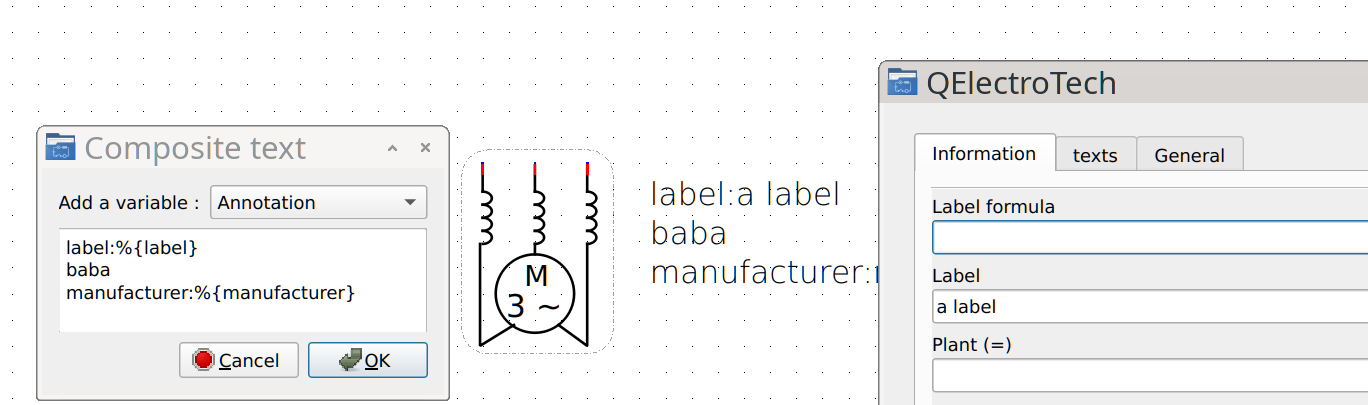

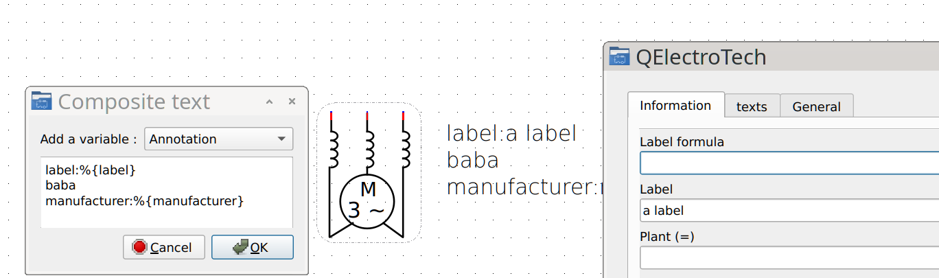

Hmm. I see. So the "label formula", which remains empty in your example and which I did try because "formula": what is that used for?
