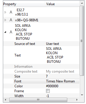

I want to ask a question. When I extract the pages of the project as PDF, there are spaces between the letters of the text I wrote in "source of text" depending on the item.
For example, the text I wrote is like this;
"SOL ARKA KOLON ACİL STOP BUTONU "
but when I export it looks like this;
"SO L A RKA KO LO N A C İL S TO P BU TO N U"
The sentences I use here are in Turkish.
What would you suggest to overcome this problem?
Thank you.

have you tried with argument "Width = 0 instead of -1?
Re: Space between letters occurs when creating PDF

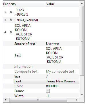

Sorry, I shared the wrong picture.  Since the font I use is Sans Serif, there is a space in between, and the problem disappears when I do Times New Roman.
Is there an easy way to make all fonts Times New Roman?
