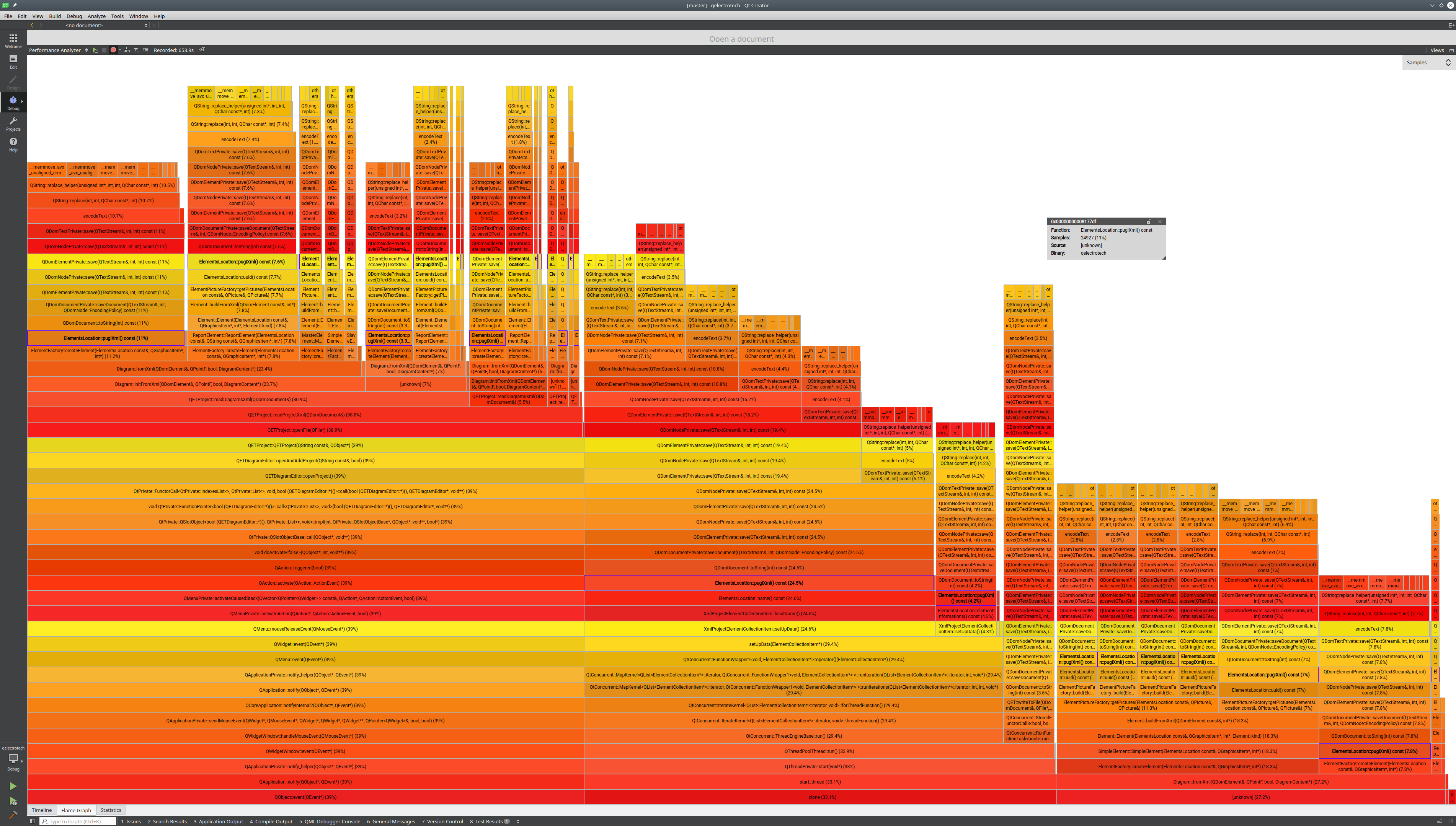

this is a fantastic file for stressing qelectrotech
more info will follow
save and load file is single thread => the long duration
the problem is that all classes in QET can write to the file, the file is then written at disc speed
if this is the problem, it is not resolved in 123
Summary
The process qelectrotech (with pid 18480) is using approximately 1.2 GB of memory.
It is using 1.1 GB privately, 35.2 MB for pixmaps, and a further 75.7 MB that is, or could be, shared with other programs.
Dividing up the shared memory between all the processes sharing that memory we get a reduced shared memory usage of 19.7 MB. Adding that to the private and pixmap usage, we get the above mentioned total memory footprint of 1.2 GB.
Library Usage
The memory usage of a process is found by adding up the memory usage of each of its libraries, plus the process's own heap, stack and any other mappings, plus the stack of its 25 threads.

testing QT Performance Analyzer wait.......
Re: Problem opening file
it is difficult to show, but the first pages are the longest
the photo shows the transition

i wonder if this is the problem,
if this is full of enters then you can get this
Screenshot_20201210_232509.png, 79.47 kb, 1072 x 823
