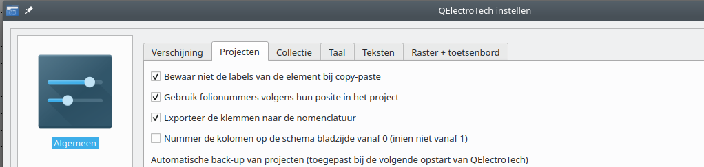

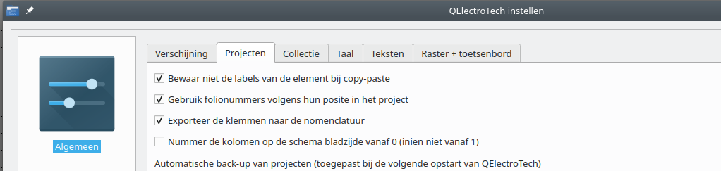

Re: transferring elements in a project between folios
this may already be in there
first line
Screenshot_20201116_203031.png, 43.48 kb, 1022 x 243
