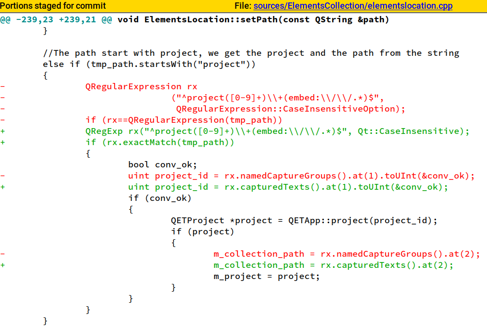

git SHA1 id
f21cdb4040940c02b4de9d201890db55de14e6b4
i have made some changes to QRegExp.
and probably it went wrong there...
update at git SHA1 id
0a46b83dca7c4f26064a9b0101b9eeeddddaf4e3

De-Backer
I think it's a little problem.
In all your comit change the code who look like this :
QRegularExpression regexp("^.*([^/]+)\\.elmt$");
    if (regexp==QRegularExpression(m_collection_path)) {
by
    if (regexp.match(m_collection_path).hasMatch()) {
I think they will fix the bug for the element, and probably all other class where the regular expression was modified is bugged.
Regard joshua.

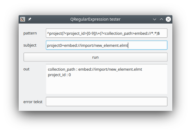

Debug: 1 QRegularExpression("^project([0-9]+)\\+(embed:\\/\\/.*)$", QRegularExpression::PatternOptions("CaseInsensitiveOption")) "project0+embed://import/new_element.elmt" (../qet/sources/ElementsCollection/elementslocation.cpp:247, void ElementsLocation::setPath(const QString&))
Debug: B false (../qet/sources/ElementsCollection/elementslocation.cpp:248, void ElementsLocation::setPath(const QString&))
in
QRegularExpression rx
                 QRegularExpression::CaseInsensitiveOption);
        qDebug()<<"1"<<rx<<tmp_path;
        qDebug()<<"B"<<rx.match(tmp_path).hasPartialMatch();
        if (rx.match(tmp_path).hasPartialMatch())

yes I will have to review everything.. of QRegExp
Revert for now.
ps test
rx.match(tmp_path).hasMatch()
fails
info QRegExp
https://doc.qt.io/qt-5/qregularexpressi … t-matching
QRegularExpression re("^project(?<project_id>[0-9]+)");
        QRegularExpressionMatch match = re.match(tmp_path);
        qDebug()<< match.hasMatch()<<match.hasPartialMatch();
        if (match.hasMatch()) {
            qDebug()<< match.captured("project_id");
Debug: true false
Debug: "0"
now this:
https://perldoc.perl.org/perlre.html
test code:
        if(re.isValid()){
        } else {
            qDebug()<< re.errorString()<<re.patternErrorOffset();

pattern is:
^project(?<project_id>[0-9])\+(?<collection_path>embed://*.*)$
I look for the other mistakes

ok i think i'm done
https://git.tuxfamily.org/qet/qet.git/c … 4c633d1701
edit
not nomicons/unsure
23:06:15.946 Debug: no Match "line-style:normal" (../qet/sources/factory/elementpicturefactory.cpp:584, void ElementPictureFactory::setPainterStyle(const QDomElement&, QPainter&) const)
23:06:15.946 Debug: no Match "line-weight:normal" (../qet/sources/factory/elementpicturefactory.cpp:584, void ElementPictureFactory::setPainterStyle(const QDomElement&, QPainter&) const)
23:06:15.946 Debug: no Match "filling:none" (../qet/sources/factory/elementpicturefactory.cpp:584, void ElementPictureFactory::setPainterStyle(const QDomElement&, QPainter&) const)
23:06:15.946 Debug: no Match "color:red" (../qet/sources/factory/elementpicturefactory.cpp:584, void ElementPictureFactory::setPainterStyle(const QDomElement&, QPainter&) const)
edit
ok
https://git.tuxfamily.org/qet/qet.git/c … 6a510617d5
night.
