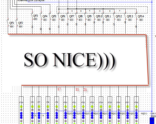

Tanks! But i need 2 label on 1 conductor.

I think it would be ideal to make a text field for a contact that would take the value of the label of the wire connected to it. And if you do not need it, you could remove it from a specific element. For example, to draw such a scheme (and I do not know how to delete some intersection points of conductors ((They interfere if to draw a loop):
If this is not possible, can add a text field to the element and program it to the label of the connected conductor? How to do it?
Not possible for element simple, possible for report element, but for now is limited with one terminal.
Your request is not very common, and asks to be studied, I don't have in head a possible hack or workaround at this time.

For me you ask about conductor type "bus" this very used in other "electronic editor", less in electrical diagrams, at this time this function does not exist in QET yet.
