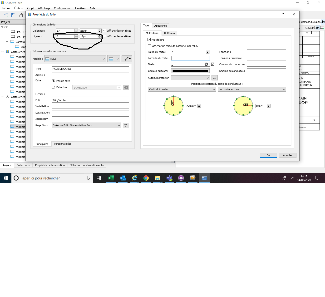

Et t'il possible de réduire la taille minimum des lignes folio

c'est pour supprimer l'espace blanc sur ma page de garde

mmm... headers
/sources/bordertitleblock.cpp:30
#define MIN_COLUMN_COUNT 0
#define MIN_ROW_COUNT 0
#define MIN_COLUMN_WIDTH 1.0
#define MIN_ROW_HEIGHT 1.0
c'est possible
diagram.cpp:2160
@brief Diagram::adjustSceneRect
Recalcul and adjust the size of the scene
void Diagram::adjustSceneRect()
QRectF old_rect = sceneRect();
setSceneRect(border_and_titleblock.borderAndTitleBlockRect().united(
itemsBoundingRect()));
update(old_rect.united(sceneRect()));
Good job, thank Simon
Je ne sais pas si Laurent vas accepter le commit
On ne peut qu'essayer.
Thanks but it' break row headers..
do you mean this?
- setRowsHeaderWidth(bp.rows_header_width);
+ if(bp.display_rows){
+ if(bp.rows_header_width<5){
+ setRowsHeaderWidth(BorderProperties()
+ .defaultProperties()
+ .rows_header_width);
+ } else {setColumnsHeaderHeight(bp.rows_header_width);}
+ } else {rows_header_width_=0;}
or this?
-#define MIN_COLUMN_COUNT 3
-#define MIN_ROW_COUNT 3
+#define MIN_COLUMN_COUNT 0
+#define MIN_ROW_COUNT 0
what do you propose, is there a way to make it?
