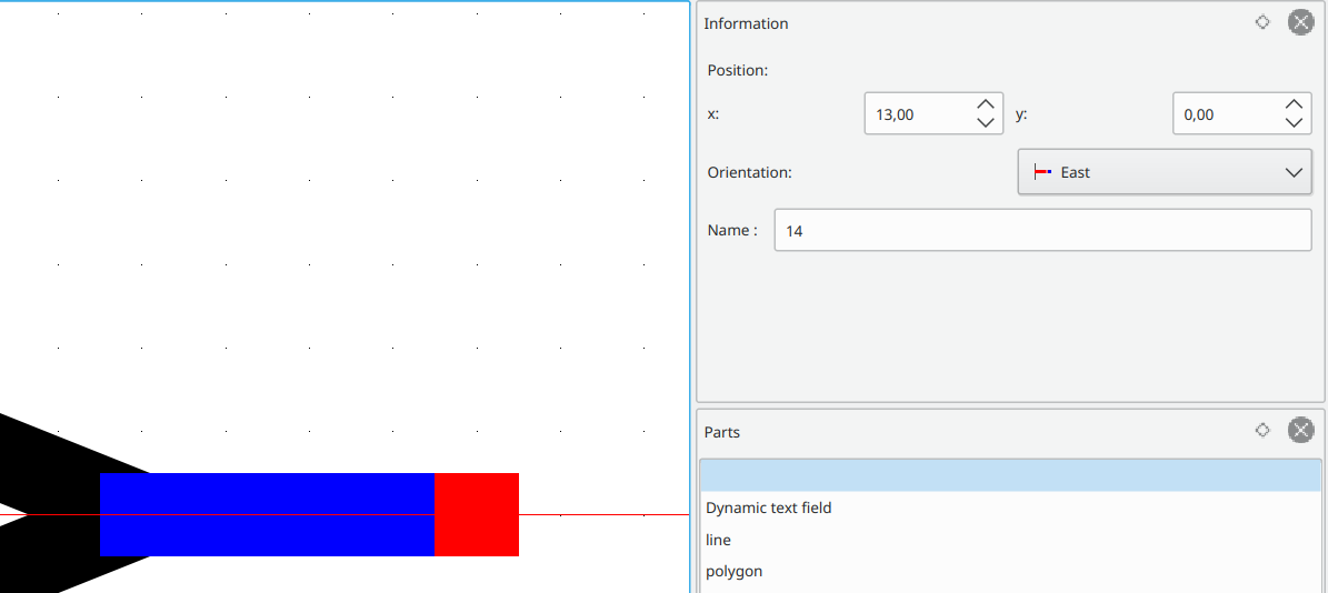

I think I got it working,
Joshua can this be tested?
in test_element.elmt

Sorry for answer you so late.
I didn't test your patch just read it, and see the screen-cast, everything look good
For me they miss one thing , add new kind of text : terminal text witch display the name of the terminal, the text should be static (not editable in the diagram editor), anyways it's good job ![]()
Also see with Martin what he already made with terminal
https://invent.kde.org/marmsoler/qelect … rce-mirror
yes I understand what you mean, but this will be some "Dynamic text field / text field", because it will never be in the right place.

In short, if you make changes to the XML structure then all developers must know and agree to it.
And that's why it's still not in the master branch.
For making a list and find the name of the attached terminal1/terminal2 to conductor see
https://github.com/qelectrotech/qelectr … .cpp#L1126
Edit fix url
Example :
Magneto therminal circuit breaker
Element name = 10Q6
uuid =
Power 3P-----conductor---*-terminal--terminal-----terminal------terminal--*----conductor
Name---------name-------*-name-----uuid-----------uuid---------name---*------name
L3----------conductor5---*-5 L3-----terminal5-----terminal6-----6 T3----*----conductor6---
L2----------conductor3---*-3 L2-----terminal3-----terminal4-----4 T2----*----conductor4---
L1----------conductor1---*-1 L1-----terminal1-----terminal2-----2 T1----*----conductor2---
