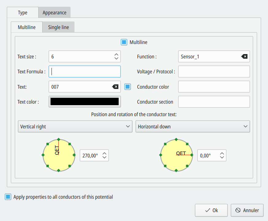

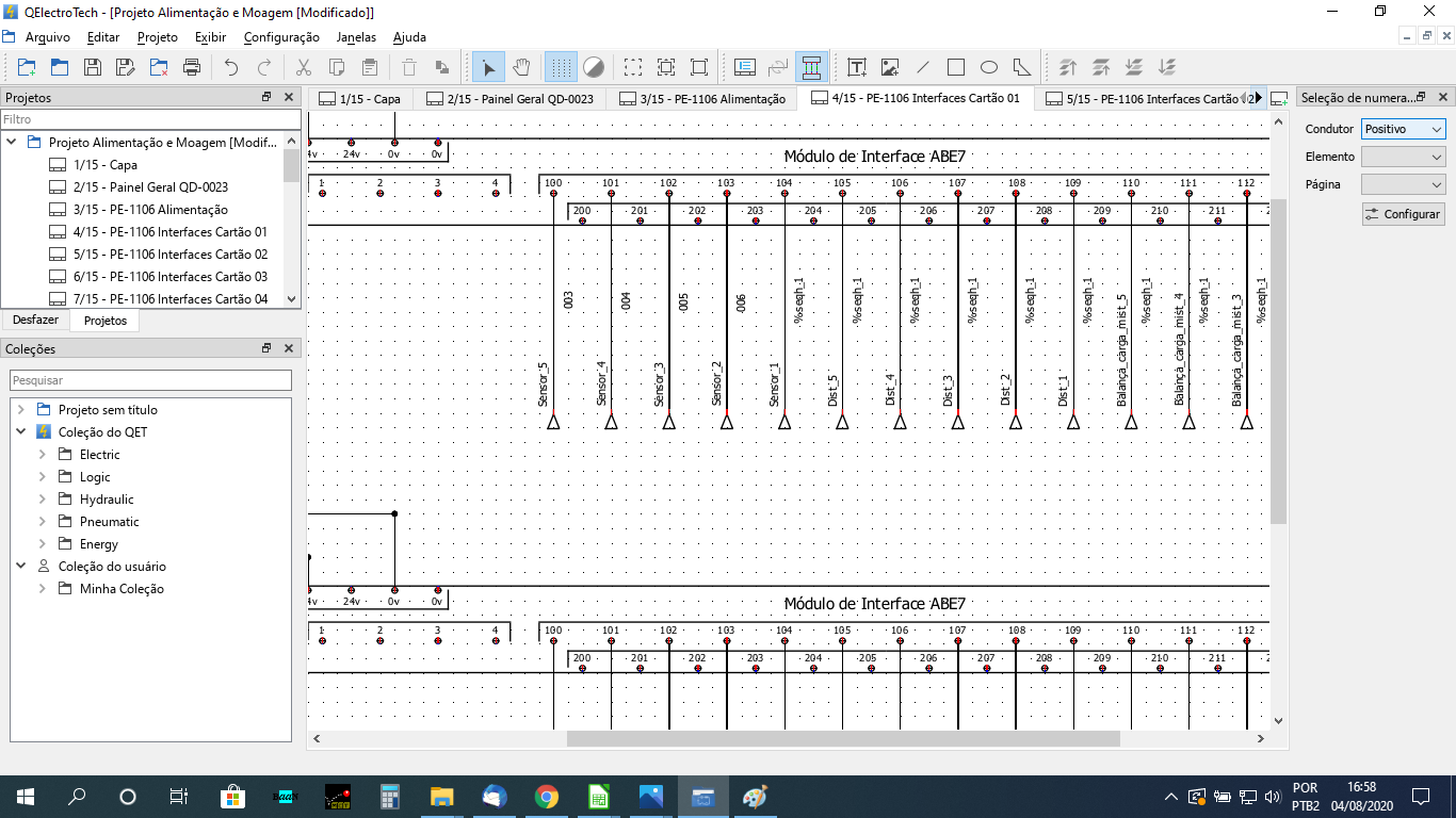

Hello. I need help! I use QEletro and when I open the project in progress I lose the cable number.
See photo.
Erro numeração automárica.png, 146.72 kb, 1366 x 768

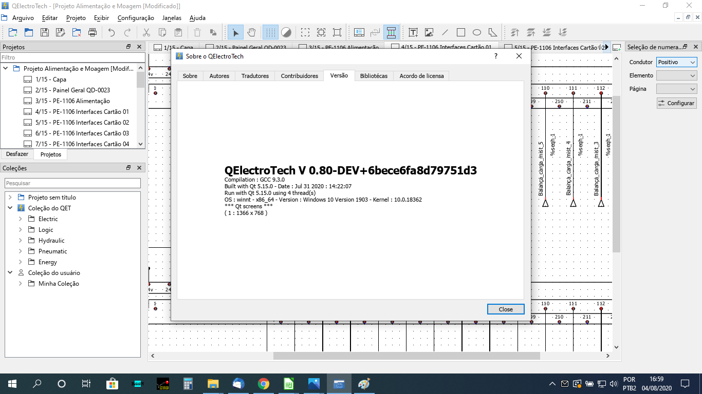

Re: Error with cable numbering
Version
Erro numeração automárica.png, 147.79 kb, 1366 x 768
Strange!
Quick fix by manually modifying some wires text and remove %seqh_1.
I don't want to rewrite the text of your functions every time if I am using the formula.
formula_bug.png, 63.06 kb, 874 x 723

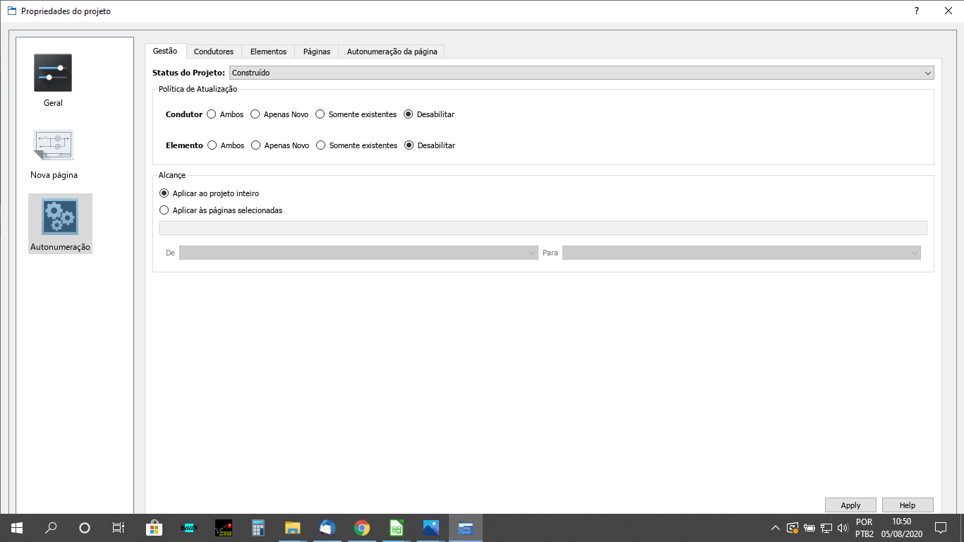

I did this just yesterday. To continue the project.
I also tried to use the completed project function, but it didn't work.
Erro numeração automárica.png, 71.43 kb, 1366 x 768
Does this not only work for new cables?
the cable numbering
does not work with cables and does not work with components. Regardless of whether they are new or added before.
