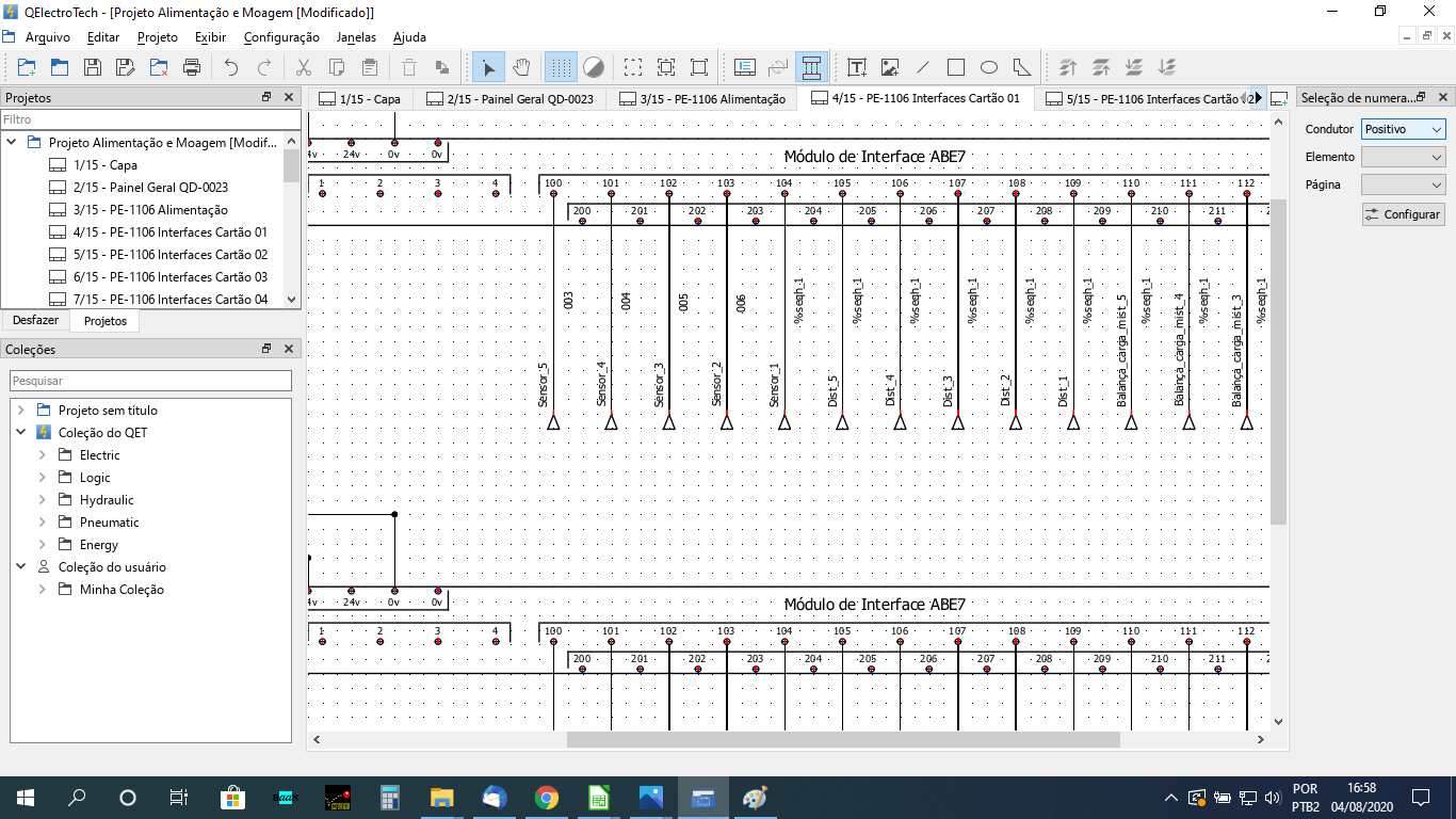

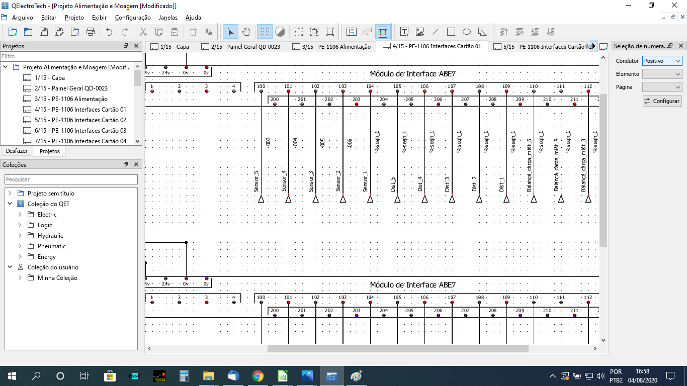

Hello. I need help! I use QEletro and when I open the project in progress I lose the cable number.
See photo.
See photo.

Strange!

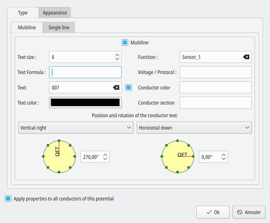

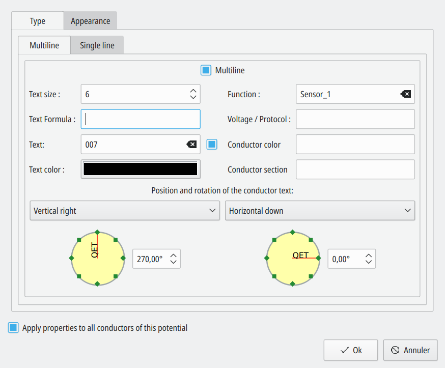

Quick fix by manually modifying some wires text and remove %seqh_1.
I don't want to rewrite the text of your functions every time if I am using the formula.

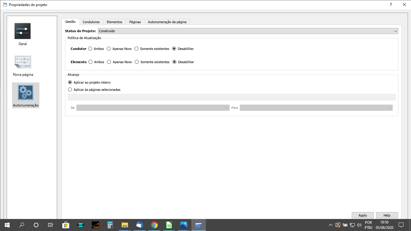

I also tried to use the completed project function, but it didn't work.
Does this not only work for new cables?
the cable numbering
does not work with cables and does not work with components. Regardless of whether they are new or added before.

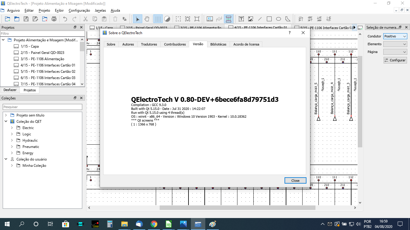

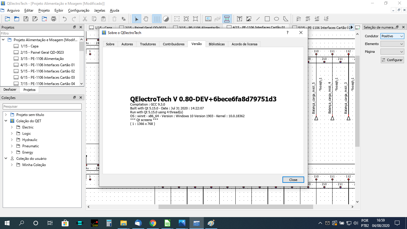

QElectroTech V 0.80-DEV
Compilation: GCC 9.3.1 20200406 [revision 6db837a5288ee3ca5ec504fbd5a765817e556ac2]
Built with Qt 5.14.1 - Date : May 26 2020 : 21:18:03
Run with Qt 5.15.0 using 16 thread(s)
OS : linux - x86_64 - Version : openSUSE Tumbleweed - Kernel : 5.7.11-1-default
1st. thank you so much for your time.
2nd. That's how I use automatic numbering. When I close the project and then open it, the numbering disappears. % Seqh_1 appears instead of the number.

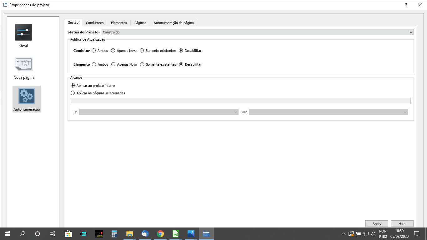

3rd. When I change the status of the project to completed, nothing happens. Should I replace the formula by number only !?
1st. no problem
2nd. When I close the project and then open it, the numbering is still there. ( windows vs linux ?? no, can you start QElectroTech in the CMD and see if there are any errors?)
3rd. I do not know.
