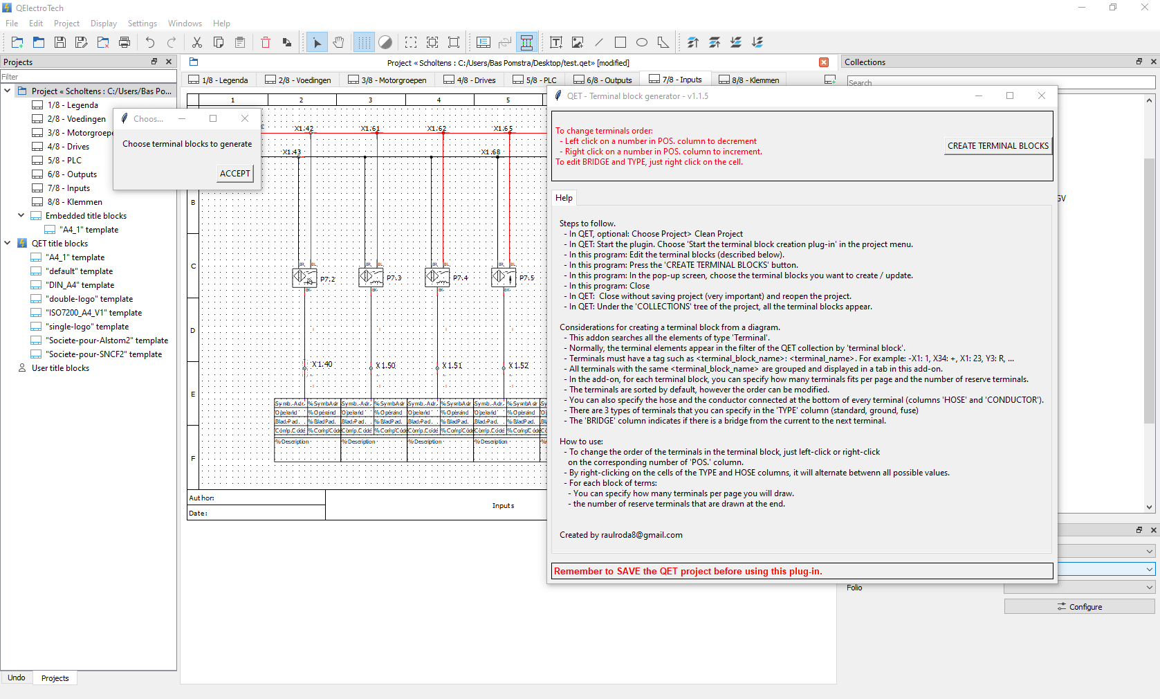

1: I have read the help of the "Terminal Block Creation plugin" but I think I am missing something ....
After pressing the button "CREATE TERMINAL BLOCKS" I get a popup with the message "Choose terminal blocks to generate".
From then on, I have no idea what to do. (see image)
[img]ElectricalSchematic8.png[/img]
2: I hope someone can explain to me how best to do PLC I/O assignments in QElectroTech.
3: I actually meant how to do this in QElectroTech. I found an old topic: https://qelectrotech.org/forum/search.p … 1278777557 but I cannot find this feature in version 0.8

Re: A few questions from a newbie
plugin work only if terminals is nanmed X1:40 and not X1.40.
Thanks, I will try and let you know.
1: I see it is in the HELP info... oops....
After I set it up properly it works, the next struggle is how to get the right info on the right place.
