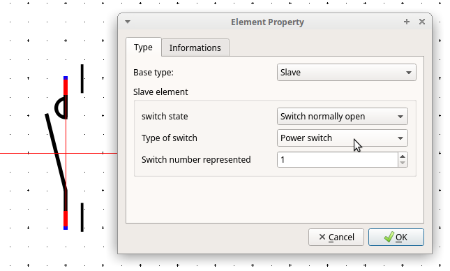

Hello
In the component editor you can assign the contact whether it is a simple contact or a power contact. Depending on this, the cross-reference element is also displayed as a service or a simple contact.
Sincerely yours
Stebo
1_2020-04-21 06:30:31.png, 29.35 kb, 645 x 388

Re: Cross reference to power contacts?
To create a slave power contact, you need to go on the element editor (see picture of calipso). In the official collection there already a lot of contact configured to be linked to a coil.
For link power contact to a coil, do the same thing as a simple contact, I think you already know how to do that if I refer to your first post.
And now if I understand well the power contact don't appear on the Xref. I think the Xref is represented as a cross in your diagram and configured to don't display power contact.
For change that, go to your project properties in the menu bar : project -> project properties -> new folio -> cross references. In this page you can configure the whole properties about how Xref can be displayed.
You can do the same configuration for new project in : settings -> configure qelectrotech -> new project -> cross references
