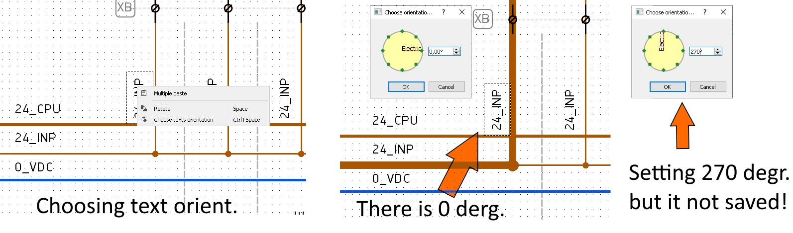

Hi!
When I change the orientation of the text on the wire label, the orientation is not saved, are there any ways to solve this problem?

Re: Text orientation (not saved)
just use "Space" key for rotate wire label, if you change text orientation in the widget when you select a wire, you need to move or modify your wire path to see label orientation new change.
Or simply right click on wire label and "Choose text orientation".
Hi,just use "Space" key
Thank you very much!
Problem solved!
