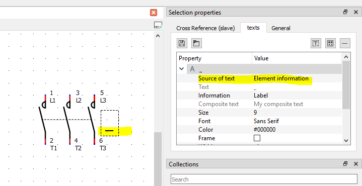

I've been using QElectroTech for a few years and I've also built a set of symbols to suit my need. Since I upgraded to 0.7 I can't edit symbol labels anymore for both included symbols and custom symbols.
What was defined as "Element information" in a symbol is no longer editable and I have to change it to "User text" if I want to set it to something else than the default "_" label. This happens for all included symbols as well.
https://qelectrotech.org/forum/misc.php?action=pun_attachment&item=1187&download=1
A "_" label is just useless and what was once simple and straightforward - setting a label for a symbol clicking on it and typing - is now hidden in the properties and requires extra steps.
Am I getting it wrong? What should I do? Change all my symbols to setting editable text fields as "User text"?

Your element is a slave element. Slave element take the matser label name automaticly when you link master like coil to slave contacts!
Put a coil in your diagram, in information widget edit label, now link your new master coil to your element  power contacts slave by selecting with right click and link.
