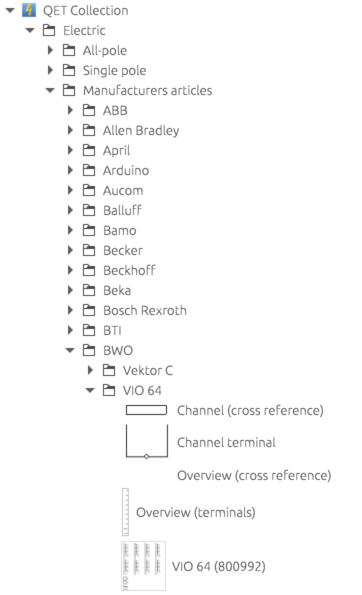

it would be better to use the "folio referencing" function (as used in the cross-ref arrows to follow a conductor on another page) as to use the master/slave function, which is not really appropriated to make what you want.
You can use those elements (see below on the picture) in the collection as template for your new plc symbols. Those BWO symbols were drawn to make a plc overview page. For each channel you have to insert the element "Overview (cross reference)".
plc_cross_ref.png, 43.09 kb, 362 x 595
