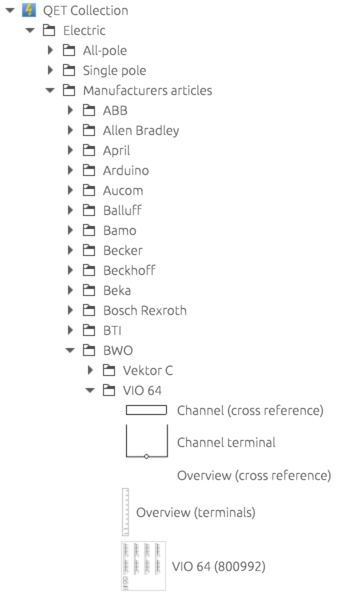

You can use those elements (see below on the picture) in the collection as template for your new plc symbols. Those BWO symbols were drawn to make a plc overview page. For each channel you have to insert the element "Overview (cross reference)".
