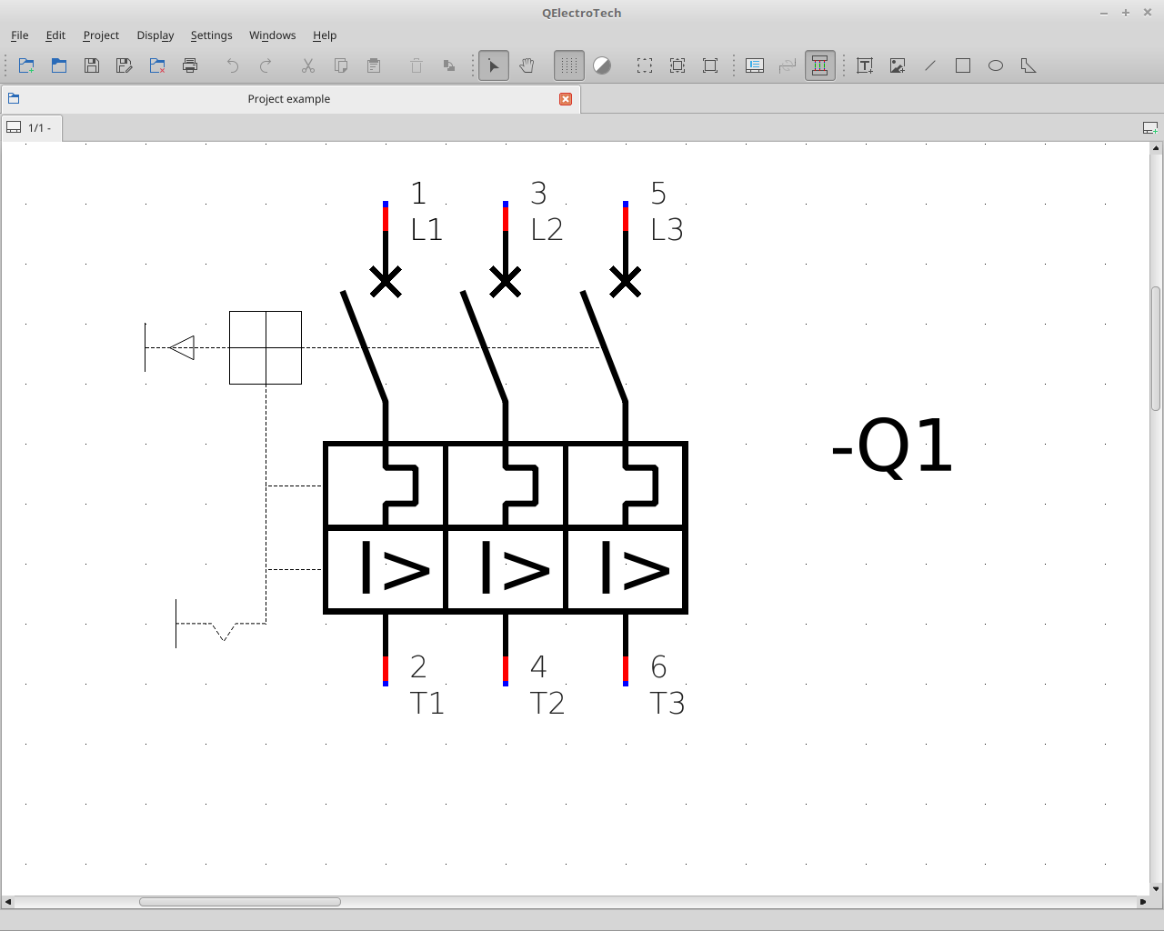

Here follows an example of what I mean (see picture):
For now all connections are addressed to -Q1. The separate terminals within -Q1 have an ID in the XML but it isn't possible to add information to them. The texts for the connections (1/L1, 3/L2, 5/L3, 2/T1, 4/T2 and 6/T3) is just plain text. It is not connected to the terminal and thus unusable for getting information about the exact wire connection.
It would be very nice in some future day to have the possibility to add label and description information to each terminal inside a symbol. This would make it possible to derive information about the exact connection and later define them in terminal diagrams, wiring schedules etc. like -Q1:1/L1
In the XML it might look like this (added RED parts of element-xml):

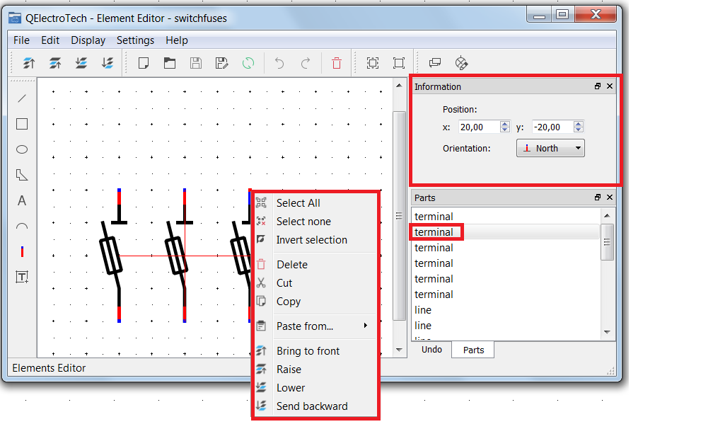

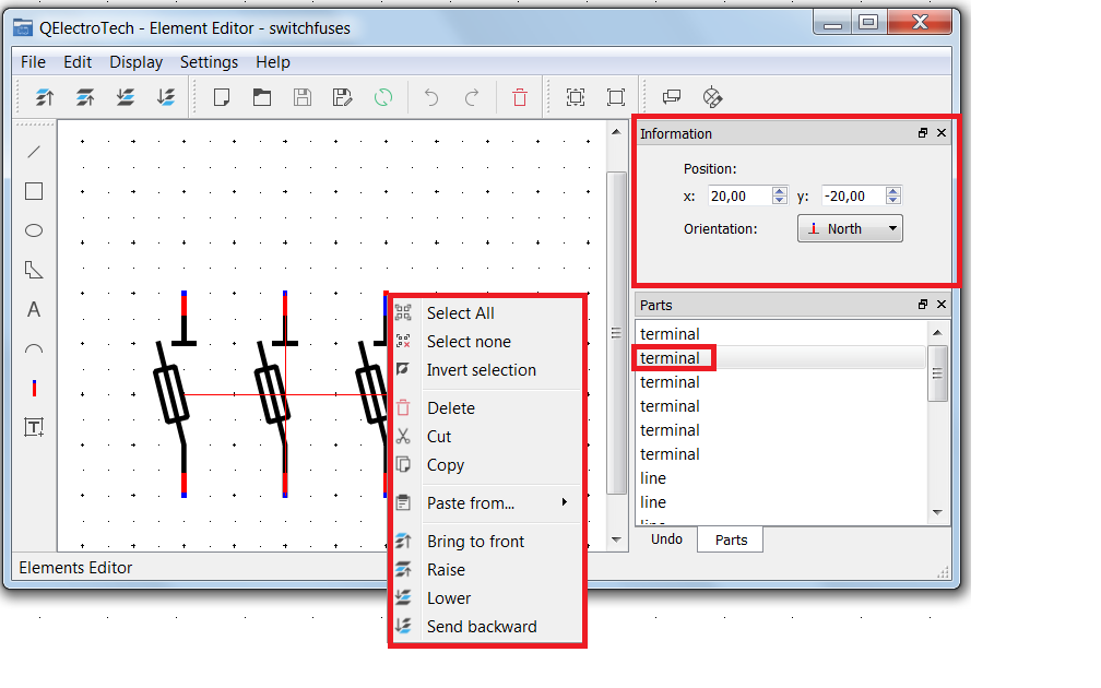

This is in the elements editor
When I right click with the mouse on the terminal a menu opens.
Unfortunately, it is not here to input the text.
In the information widget , the text input and the text x and y coördinates are also not there.
Can this be added?
Is this done,then I think that the problem is solved.

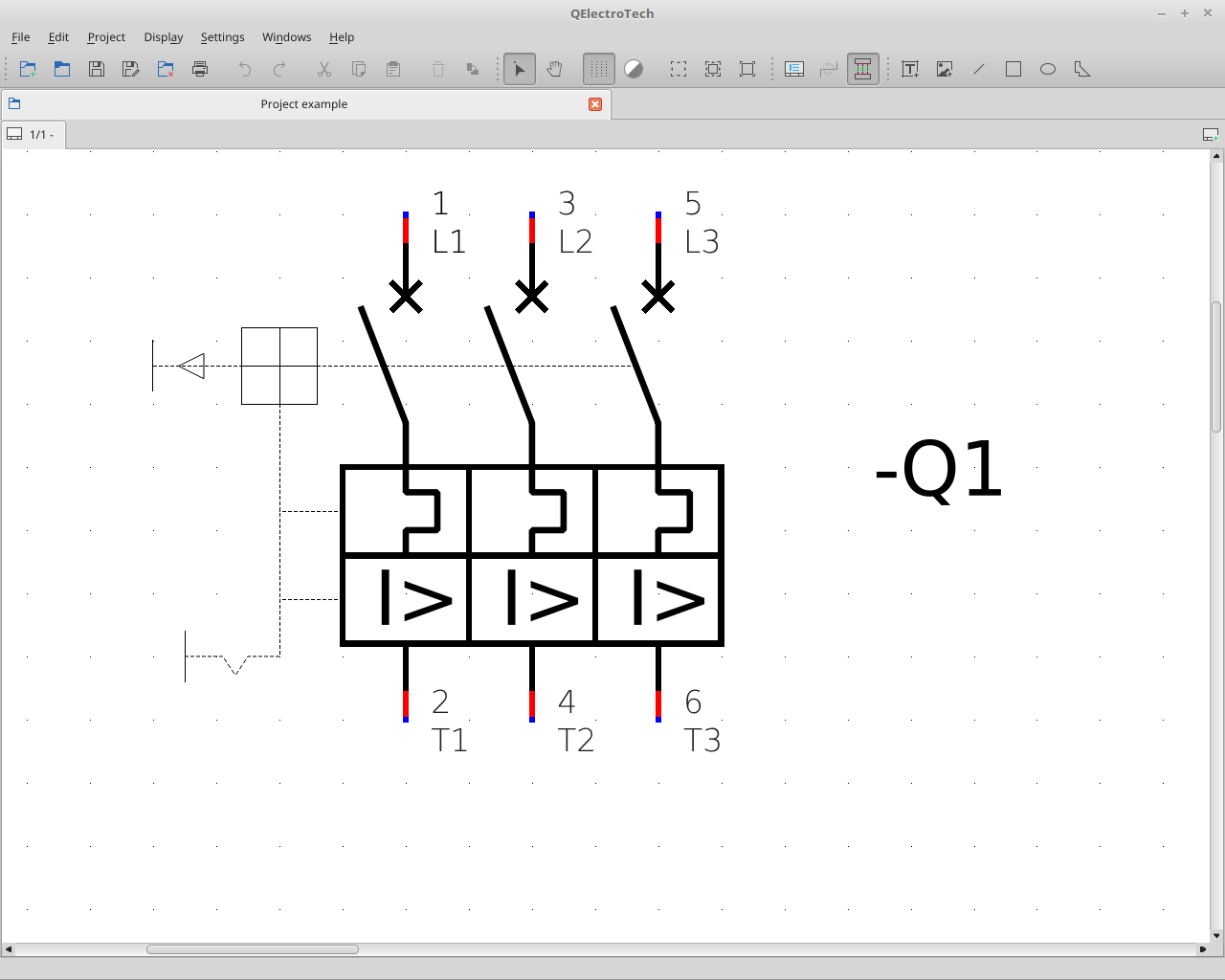

A feature that might improve the QET for making all kind of connection descriptions like Terminal diagrams, Wiring lists etc. will be the possibility to add text to the QET-terminals within symbols.
