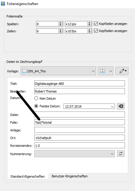

@scorpio810: Thanks for your response. I understand your first post that propose to change the code from Line 822f the same way as the code form Line 363f to find the number of the last line, is that right?
Is there a tutorial to recompile the project after havin made the changes?
In the second post I have no idea where I do have to make the changes:
- in the properties of the folio:
- or in the properties of the element:
And what should I exchange, i.e. %f by %F, I have no idea because there is no translation from "folio label" and "folio position" to german
Thanks
Robert
