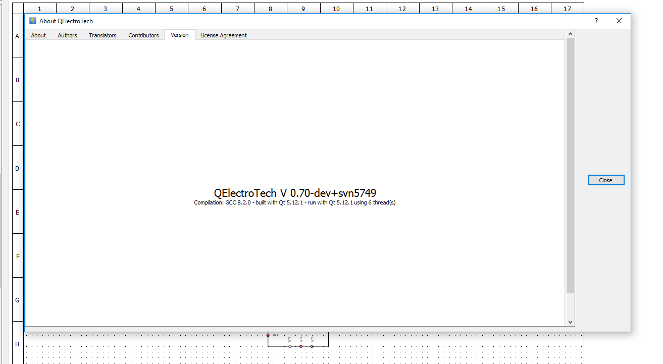

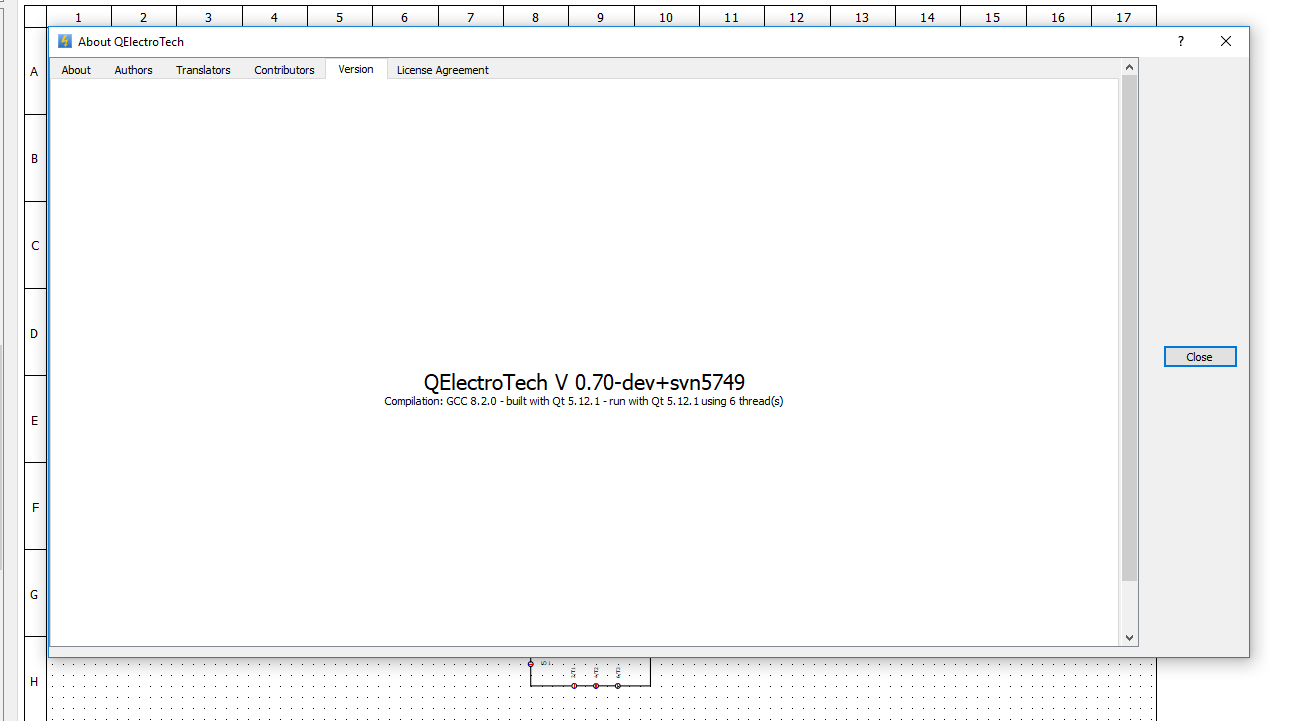

Version attached. thanks again for your help.

Re: Text size when opening Old Project
Isn't the latest, please upgrade, thanks.
5749 is build the 24/02/2019.
DOH!nomicons/blush  updating to RC2 5942 has fixed the issue.
