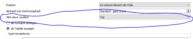

Hello Stromie,
we thinking is better in project cross-reference settings, Joshua want to guide you.
https://download.qelectrotech.org/qet/forum_img/stromie_patch.png
Re: Abstand Zwischen Betriebskennzeichnung und Querverlinkung
ok, then we do this
16 (edited by stromie 2019-07-19 19:58:02)
look like this
Menu.PNG, 8.14 kb, 792 x 161
