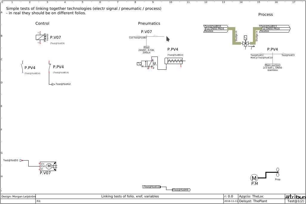

Three days ago i started making a drawing to practice some style.
Next day i was to continue, but now i see some variables are not evaluated like they were originally!
1) %projecttitle is not evaluated in the title block
2) %filnamn which is a custom variable also define din Project properties is also no longer evaluated in my title block
3) In folio properties I use %id as a part in the folio field, as a method to get page number in the folio list.  For each folio i edit it to be a short name + @ + %id, like this: Pump@%id and it generates i.e Pump@7 if it is page 7.  For all folio links and xref links i use the variable %F%l%c to make it show like Pump@7C8 there.  That all worked great earlier in the week but now page numbers are not evaluated and it writes "%id" instead.
4) This is really insane:  After i save and reopen, i see a new language for the text in title block first row second last column !? A new for every time i reopen!?  Checking the title block settign si see it have deleted the en line.   In the attached screenshot is looks like greek.

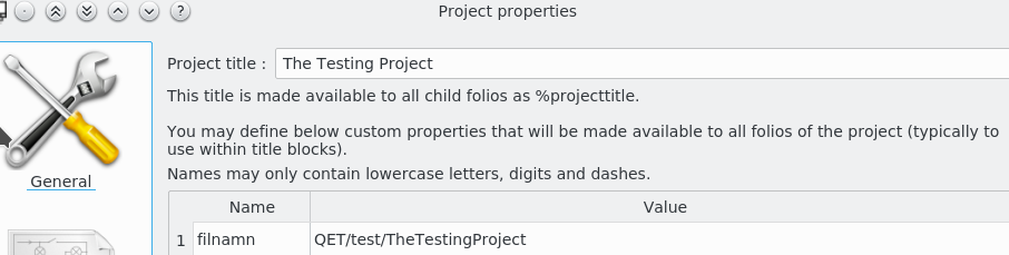

Regarding 1 & 2:
Strange, it have before worked to enter project title and variables like attached.
I dont understand when that works and when not...?
Re: Variable evauation fails, and title block getting damaged
Yes, but you don't need to add these variables in new folio also.
If you add this variables in titlebloc field that override the first variables ...
https://qelectrotech.org/forum/viewtopi … 4695#p4695
https://qelectrotech.org/forum/viewtopi … 4703#p4703
https://qelectrotech.org/forum/viewtopi … 4705#p4705

Yes for 3) let it rest a few days while Joshua is redoing things...
Any idea about 4)? Do you also see it changing language?
Yes it is a bug, master, slave element and report folio also, can't read this titleblock variable now (%id).
Thank you for report it.

In r4776, %id entered as part in the folio propertied "Folio:" field evaluates correctly in:
  • folio refs
  • xref at slaves
  • List of folios (the page(s) generated by menu Project > Add a summary)
But not in
  • xref at masters (i think it did work before)
  • QET Projects list pane.  (I have never seen it work there, but would be nice)
Example: try the file above at https://qelectrotech.org/forum/viewtopi … 5884#p5884
