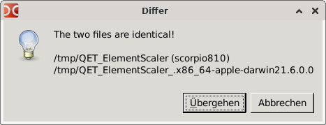

22 (edited by plc-user 2022-10-12 19:46:26)
Re: Mirror or Flip
Thank you for trying, Laurent!
I didn't think of comparing "my" file with the one you uploaded here on Sunday and have done so now. You can see the compare-result from DoubleCommander in the attached screenshot: Our binaries are amazingly identical! Amazing, because we definitely compiled on different machines and at different times. Compared a second time with "cmp" on my Debian-Box and it also says that the files are identical.
The message in your case I could imagine that the file looks like it has a file extension because of the added part after the underscore and therefore mac doesn't recognize it as an executable file? Maybe the file will be recognized when you rename it?
Does mac have an "executable-bit" for files? (chmod 744 ....)?
Bildschirmfoto_2022-10-12_19-23-42.png, 16.54 kb, 467 x 179
Re: Mirror or Flip
You forgot to make it executable and rename it without point.
Rename it to QET_ElementScaler_x86_64-apple-darwin21-6-0-0
But it 's strange  I don't use if I'm remember chmod to make it executable... saw my previous capture.
https://download.qelectrotech.org/qet/forum_img_2/plc_user3.png
After chmod +x is work
https://download.qelectrotech.org/qet/forum_img_2/plc_user4.png
24 (edited by plc-user 2022-10-12 20:17:43)
Re: Mirror or Flip
OK, will use a filename without points next time!
Edit: When compiling something the result is automatically set to be executable.
But do I have any control over the file permissions when I upload something to github? Or is it the user who sets the permissions him/herself after downloading the binary? As far as I know it's the second, isn't it?
Re: Mirror or Flip
Same here: when I upload like AppImage file I revert executable flag on files before upload on server.
chmod -x your file.
https://qelectrotech.org/wiki_new/doc/p … n#appimage
