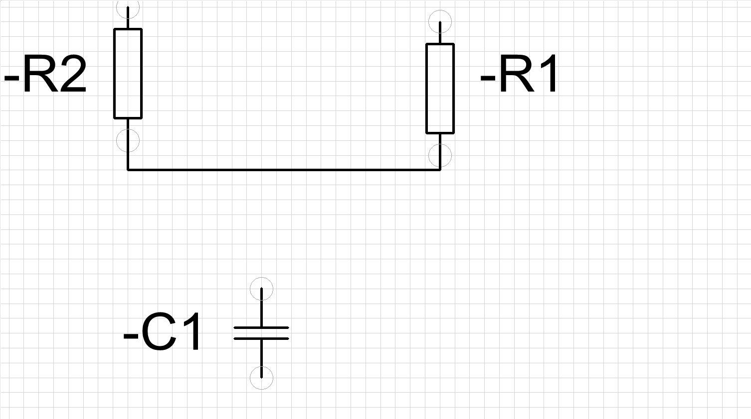

I use at work as other programs which were bought by the employer. In them such opportunity. Connection directly to the conductor. But not to an element conclusion. Now it is necessary to edit that was beautiful.
I want to know your opinion.

Hi Aleksandr,
you do connect your conductor to R1 or R2.
See online manual : https://download.qelectrotech.org/qet/j … l/QET.html
Re: La connexion au conducteur
  [font=Arial]By definition the conductor between P1 and P2 is already potential. And if to set a condition that the wire and a conclusion of a detail is one potential, it would be possible to attach a wire to such conductor. For this reason the wire changes color when this condition is satisfied.[/font]
[font=Arial] It is so made in other program. [/font]
Yes we know, but Qet works differently at this time.
Perhaps in a future ... we can add element insertion in wiring.
