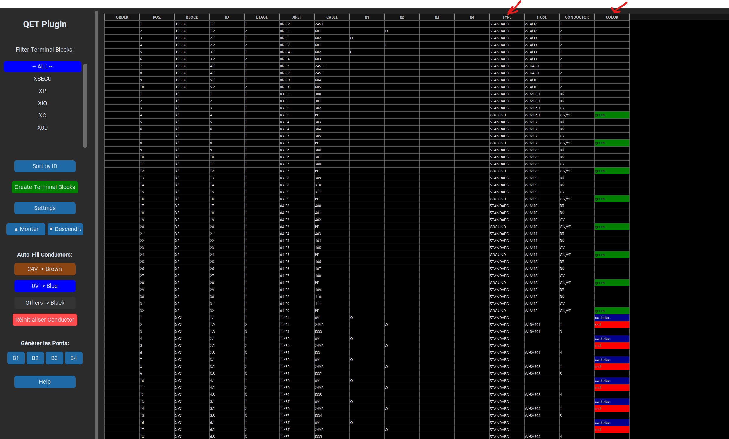

updated on pip today, to replace object position problem with tkinter with long terminal list
now work with tksheet for best response and long terminal list
can be launch from qet or as standalone executable downloadable in release
https://github.com/XavierDeven/qet_tb_g … /tree/main
https://qelectrotech.org/forum/misc.php?action=pun_attachment&amp;item=3696&amp;preview&amp;secure_str=3104t3115
Capture d’écran 2026-03-23 005053.jpg, 592.21 kb, 2500 x 1507

you can click on header type to set ground automatically if cable is names pe
and you can also click on color header  column to set blue red green if cable is contain 0V, 24V, 48V OR PE
