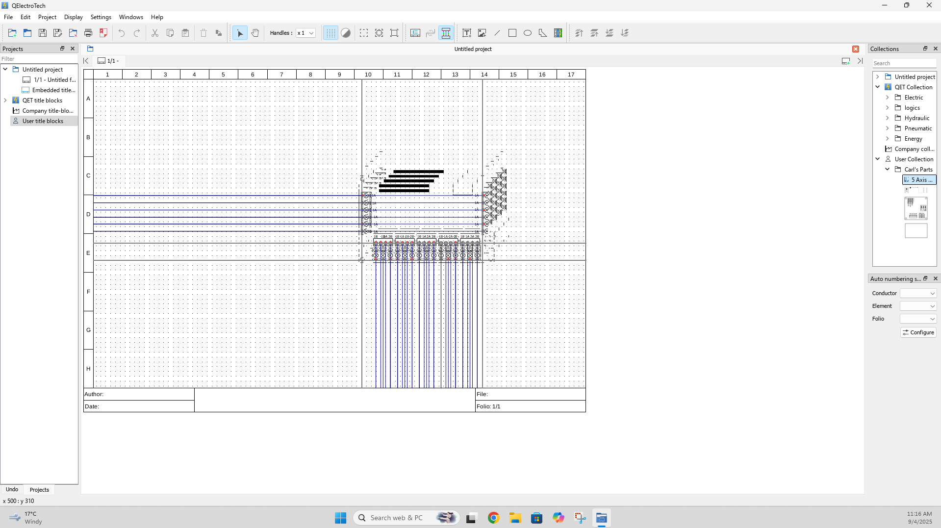

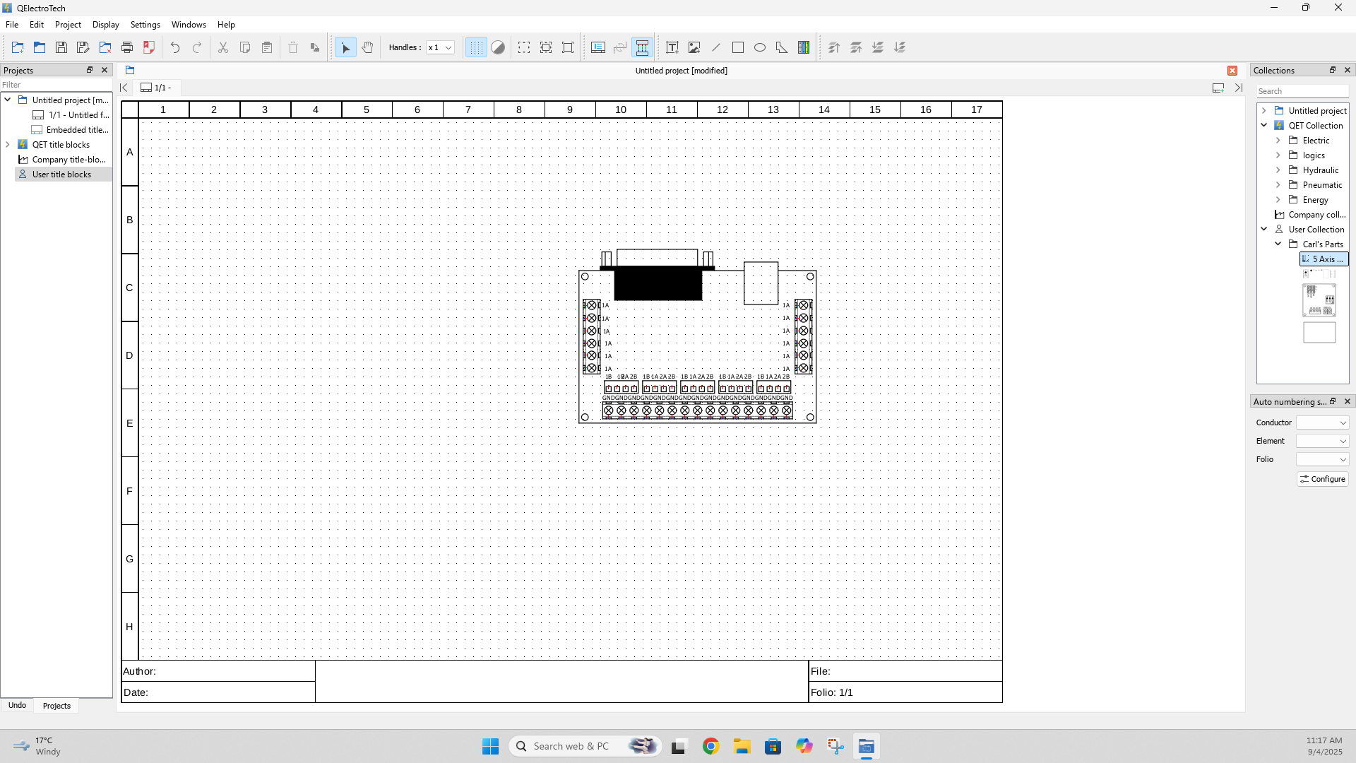

"Placing element", is the screen shot of me dragging the element on to the page.  the echo occurs after it has been placed.
"Element placed", is the screen shot after I de-select the element and move the page to refresh it.

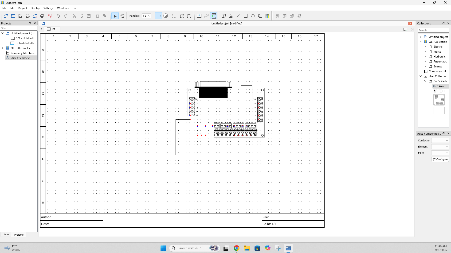

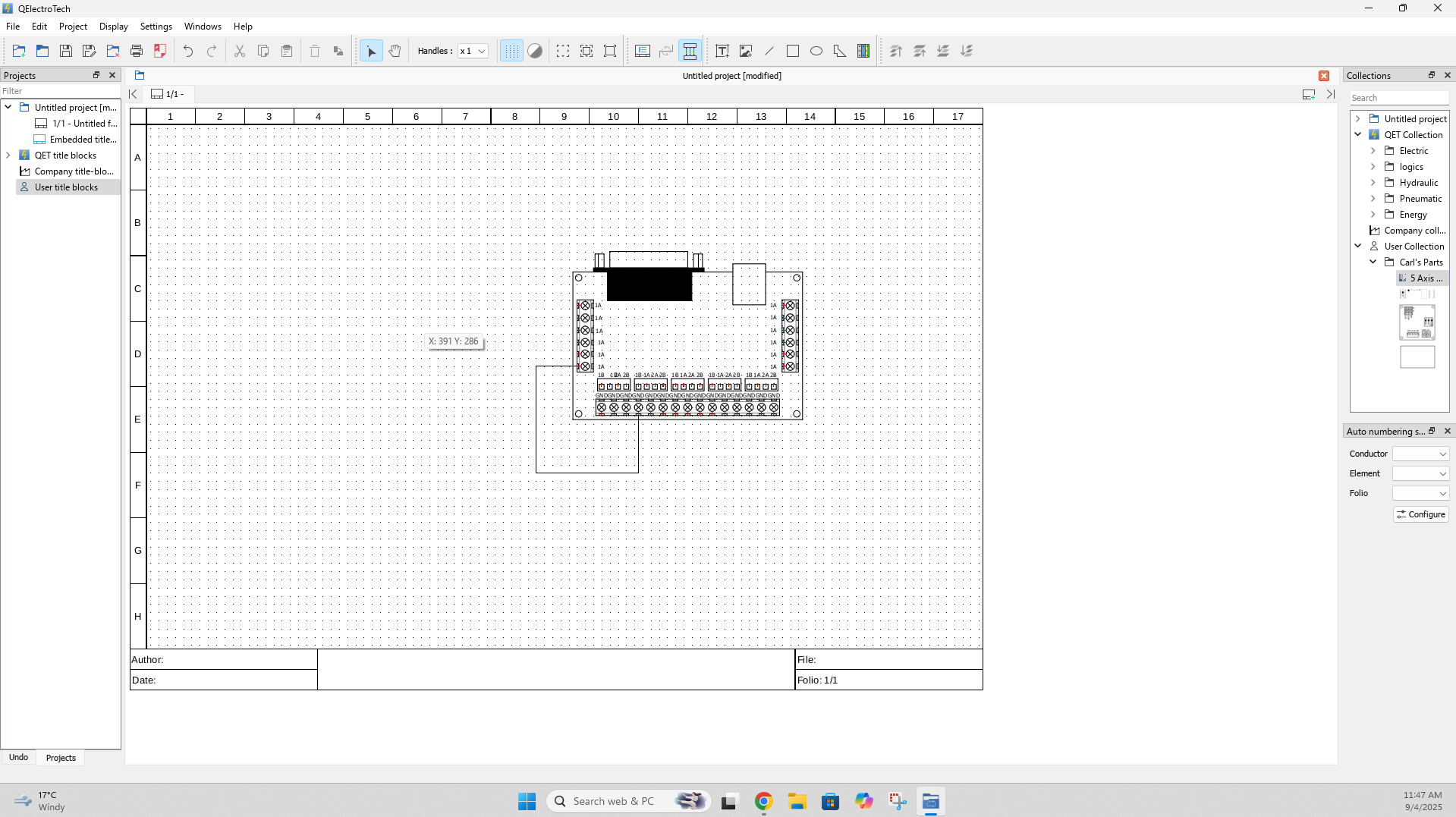

"Making connection", is the screen shot of a connection being made.  In ver. 0.9 the image was not lost.
"Screen refresh", is a screen shot of the connection after refreshing the page with a mouse movement.

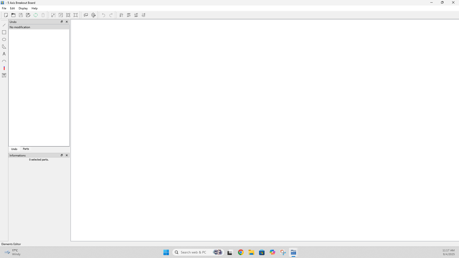

"Element editor", is a screen shot when I right click the element and select edit.  This is the only way I can get to the editor as the element can not be selected once it is placed.

Re: New custom element
It's a very rare case but it happend to me about 3-4 years ago in my experience...
Analyzing your elmt :
- Value position contain like 2.95
- Value position contain nan
Why that can be happend :
- Transforming (Moving/Rotating) multiple different object (shape|text|terminal) in the same time (together)
- CopyPasting multiple different object (shape|text|terminal) in the same time (together)
- Initiating a new blank element at first by copypasting multiple different object from another element
- Moving/dragging multiple different object all almost done by mouse
How to avoid :
- Transforming and CopyPasting multiple different object(shape|text|terminal) separately
- Often to check value position like 2.00 is stable | 2.10 is oke | 2.11 is danger
- If you find an object but value position like 1e72324 fix it immediatly and dont copypaste from it and create similar in a new one
- Using arrow keys and change value box
How to resolve (Notepad) :
- change value like 2.95 to 3
- change value nan to any digit
How to resolve (QET Element Editor)
- After fixed it by notepad, open it in QET Element Editor and edit your element
OR
- Even it is fixed successfully, i suggest you strongly build a new one similar and dont copypaste
from your fixed element (personally it can be a nightmare for me)
Quick Tips :
-Build all shapes at first
-Add all texts after
-Add all terminals at last
hope this helps
