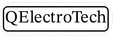

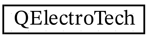

What I want to do is add a text box. However, the edges of the frame should be rounded. Same as below:
Element.png: Edit The Element -> Text -> Property -> Frame
Text.png: Add A Textfield

Whatever I did in the code above did not work or I lack information.
I would appreciate your help. Thank you very much.

QElectroTech uses the RichText-Editor from Qt for Text-Fields.
"border-radius" is supported by plain html / css but not in RichText-Editor of Qt:
See here: https://doc.qt.io/qt-6/richtext-html-subset.html
As a workaround you may create an element with a rounded rect, place it in diagram and place a free text above it in diagram-editor...
