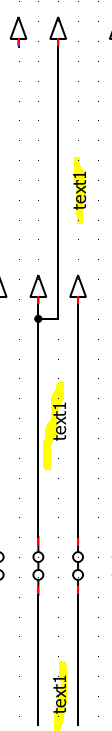

Yes, like bus or more simple - just two different wires going into one connection point but keeping unique texts.
E.g. as shown in the image where going arrows reference two different measurement channels and would like to have different text1 and text2

Hello
if you using wires or joints, or splices, drag and drop official symbol to your custom collection, open it in element editor and change the type of your element   "terminal" to "simple" or create a new symbol from scratch and select type "simple".
Element with "terminal properties" keep equipotentiality. Same for element report folio!
Haven't seen your reply. Thank you, I will give a try!
Update:
Yes, working!
