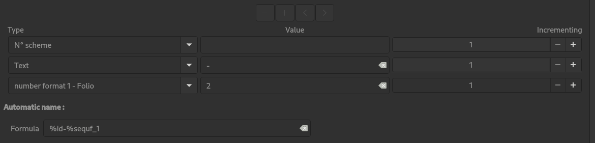

I managed to setup the Auto-numbering and it works great for conductors. I am using a formula where I label the conductors with the folio number - index of conductor in that folio
https://qelectrotech.org/forum/misc.php?action=pun_attachment&item=3009&download=1&secure_str=7080f13
But I discovered that whenever I navigate to a different folio, the sequence counter resets itself, so when I come back to this folio and continue adding conductors, now I have repeated names.

However, the answer is not exactly what I am after. I don't know if what I have in mind is how it should work, or this would be a feature request, but how I am trying to label the conductors is using a formula which would label them with the folio number (ideally it will be auto updated if the folio number changes) and an index number unique to that folio.
For example, conductors on folio #3 would be: 3-1, 3-2, 3-3, etc. And conductors in folio #4 would be 4-1, 4-2.4-3, etc.
This would basically require that each folio have it's own persistent variable for the current count on itself and not reset when I select another folio.
Using the formula that I posted at the beginning ( %id-%sequf_1) seems to have this logic in mind, the only issue seems to be that the sequence advances on some sort of "Volatile" variable because when I change folio, it will then reset to the value on %sequ_1, which does not get increased by the method which increases %sequf_1
If I use the formula that you suggested, The conductors show the following: "3/4 - 1". Showing the folio of the total folios, and following 1 sequence across all folios which is currently not what I am after.
