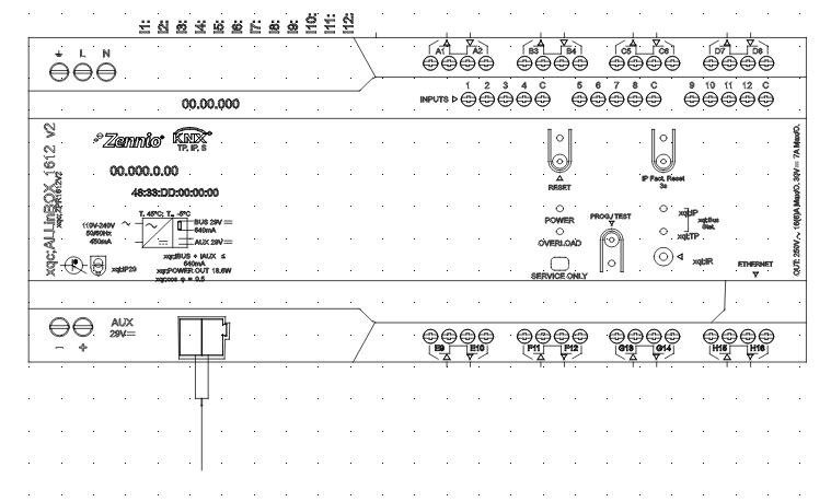

Hello,
I tried that, you have to dissolve the dxf drawings. This breaks the dxf into individual drawing elements, then all lines are converted. The texts on the dxf are not all text elements but rather individual lines and make the file very large and post-processing makes sense.
Best regards
Stebo
