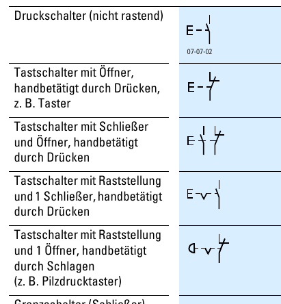

EDIT:
If you think the "kink" in the dashed line is not properly recognizable, then I must refer you to the creator of this element: The drawing is not correct!
These kinks in the dashed lines represent a kind of "notch" for the actuation, which (since I have been working in electrical engineering) is shown with a solid line. Only the notch, not the rest of the mechanical connection of the switching elements! In the attachment you find a screenshot from "Eaton Schaltungsbuch 2023" PDF-Page 485 (https://www.eaton.com/de/de-de/support/ … sbuch.html)
Have we found a volunteer here who wants to fix this error in the elements, Erik?  nomicons/wink

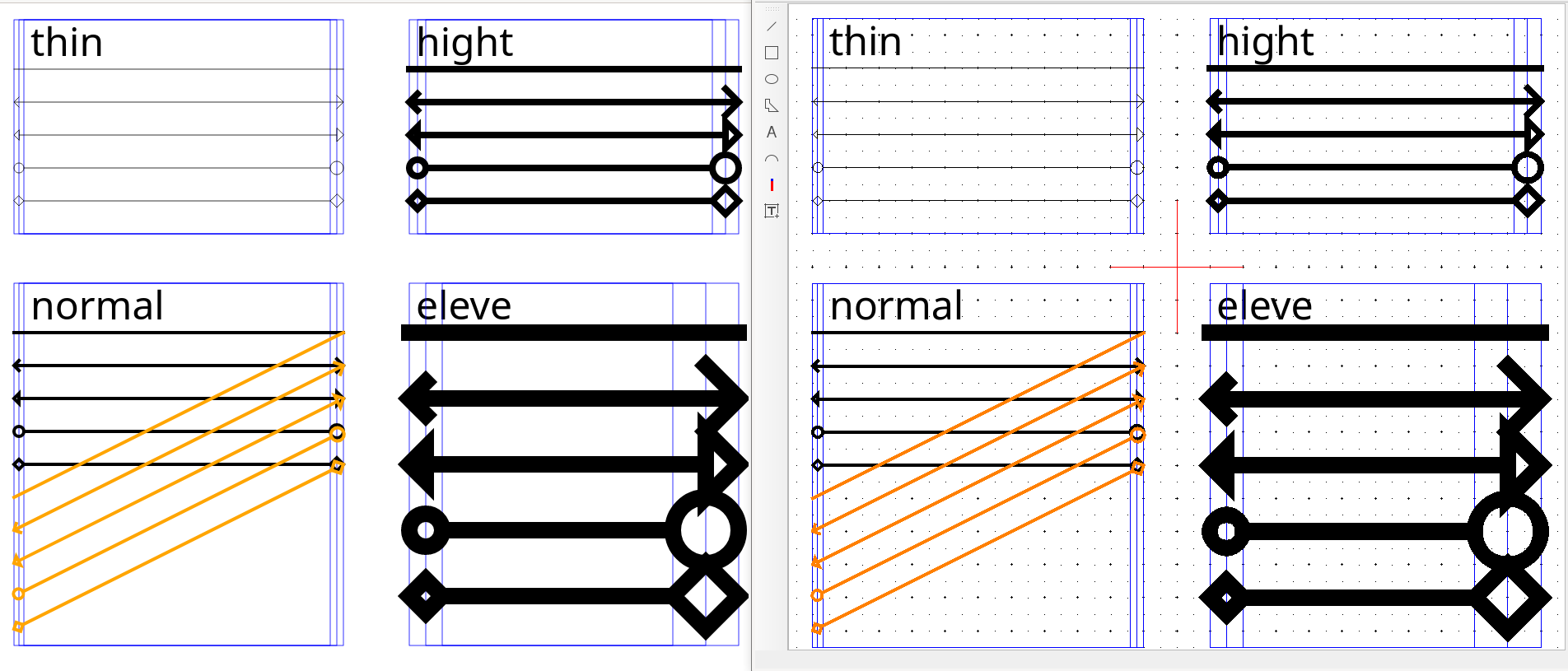

Re: QET-Element to SVG
Line-Endings for SVG-Output are implemented now!  nomicons/smile
Additionally: Line-widths and the dotted and dashed lines were slightly "adjusted".
On https://github.com/plc-user/QET_ElementScaler you find a new pre-release.
In the attachment you see an example: SVG on the left; QET-Element-Editor on the right.
The blue rects in the background show the positions of x-values of the lines and the distances "length1" and "length2" of the Line-Endings.
For me the lines left/right look very similar!
We get closer to a first "non-beta" release.
The next great step will be texts with line-breaks. More on this: later.
Best regards
  plc-user

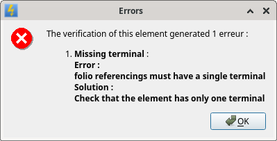

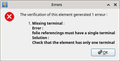

I searched the elements-directory and found 4089 Elements with "input", which was the old element-part of actual "dynamic_text".
As explained above: Then I opened all of them in Element-Editor and saved them again in the actual file-format.
Some of the files represent References, which caused errors when trying to save: see screenshot in attachment.
I also attached these files in a *.tar.gz.
I  might create a PullRequest at GitHub to update the QET-Elements which could be saved without errors.
Do you think I should, Laurent? Would be a bigger change ... nomicons/wink
Hallo Plc-user,
these elements serve as folio reports and allow you to link two different components, as these components are of the folio report type it is mandatory that there is a one terminal, this is why you have the warning widget.
These elements tampered with as folio reports are very useful and some people use them a lot...
It's based of me's workaround like this vidéo:
these elements serve as folio reports and allow you to link two different components, (...).
Don't get me wrong: I want to keep these elements!
All I want is to get rid of those "input" inside the elements and replace them with "dynamic_text" to have elements that were created using the current version of element-editor!
In the attachment you find a *.tar.gz with updated elements.
Would someone who uses them regularly please test if they work as expected?
If so, I'll create a PullRequest with all 4089 updated Elements.
Attachment icon qelectrotech-elements_REWORKED_REFERENCES.tar.gz 11.65 kb, 235 downloads since 2023-12-19
