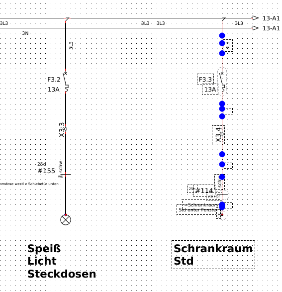

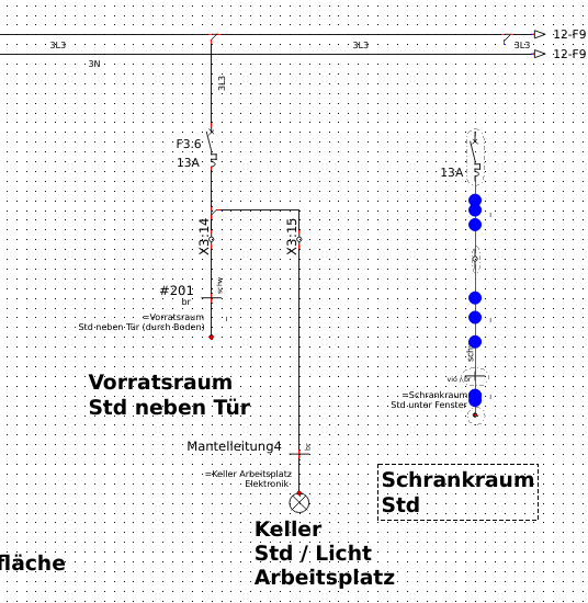

I have some connection path (I don't know how to name it correct, in german I would say "Abgang") on, let's say folio 3.
I want to move the whole connection path to folio 2.
-> select, STRG-X on folio3, STRG-V on newfolio.
It works in principle but on new folio, I loose some information like

Re: Copying/Moving some connection to other folio - loosing information
https://download.qelectrotech.org/qet/manual_0.7/build/_images/qet_configure_project.png
Un check the fisrt option.
